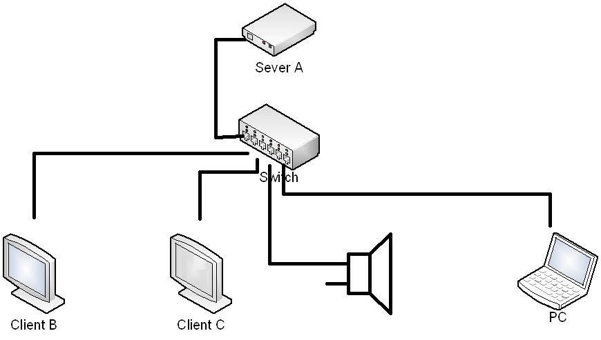

1. User Case:
  • Demo Architecture:
  • Demo Description:
    • A, B, C and Speaker all are i.MX6DQ SabreSD board and running Ubuntu system.
    • A is media server which send out broadcast 30Mbps h264 video and audio stream and running iperf to send out tcp packets via best efforts lane to PC.
    • B and C are clients to get video data only and play in screen.
    • Speaker is a client to receive audio data only and play to speaker.
    • PC which install ubuntu system is used to received best efforts data from A.
  • Demo Goal:

If server A , Client B, client C and PC all are running ubuntu so on which machine we need to run avb kernel?

Ubunut is only a rootfs (file system), the kernel is Linux3.0.35_4.0.0 which embede the AVB driver.

Hi Jithin,
     There have no kernel print to confirm AVB is working. I am wondering what’s video clip do you test, how much the bitstream? I suggest the bitstream of the video clip is as big as possible.  I use 27Mbps video clip to test (H264_AVC_1080p_30fps_27Mbps_mp3.av).
     I have no image for Sabre-AI board, I only have these image for Sabre-SD board for your reference.
FYI, I have sent a mail last week to you with attach image and same content as above, didn't you get it?

Hi Kajava,
    Actually, I didn't test the AVB function using camera, I use the video clip to playback in server side and see and hear in client side. In order to demo the advantage of AVB, the server not only send audio and video stream, it also send best-effort etherent date to PC. For example, the current network bandwidth is 100Mbps, and no video to playback in server, the PC can receive the 80-90Mbps best effort data, when playback a 30Mbps stream video clip, the data throughoutput of the PC can be reduced to 60-70Mbps, the video can playback smoothly in client side at same time, it confirm the AVB function is working.
Normal switch is OK, don't need AVB support switch.

HI Anand,
Maybe my explanation confuse you, sorry, let me explain it again.  From the above graphic, The talker(server A) provides the outgoing Audio Video streaming over the Ethernet.  The listeners(Client B, Client C and Client Audio) receive Audio/Video streaming and play back/display. In the demo, all the devices are connected via a 100M TP-Link switch.  Except for the AVB streaming, we will add extra Best-Effort traffic outgoing from talker to Notebook. The AVB streaming and Best-Effort traffic will compete for 100M bandwidth. The QAV is expected to guarantee higher priority for AVB streaming in TX queue.
