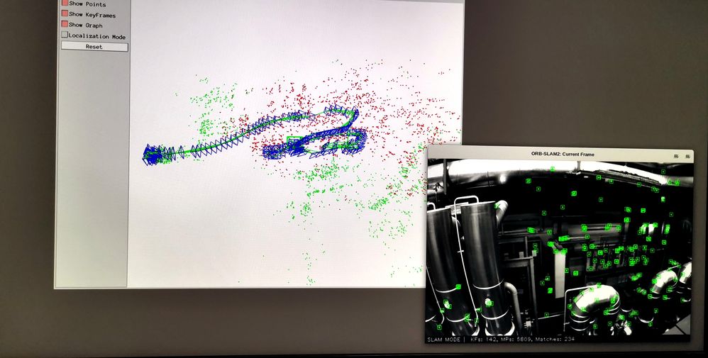

F, vSLAM demo
You can find orb-slam2 demo under <i.MX Yocto folder>/sources/meta-robot-platform/imx/meta-robot/recipes-demo/orb-slam2. You should choose DISTRO=imx-robot-xwayland due to it depends on OpenCV with gtk+.

4, Add imx-robot-agv image with orb-slam2 demo
5, Fix the issue which failed to create image when adding orb-slam2
6, Fix the issue which failed to create imx-robot sdk image when add package ISP and ML
Note: Currently, orb-slam2 demo don't run on i.MX8MM platform due to its GPU don't support OpenGL ES3.

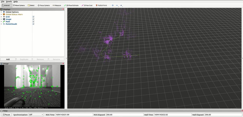

1, Add vSLAM ROS demo based on i.MX vSLAM SDK and i.MX AIBot.
The demo video is here:
Autonomous Navigation with vSLAM, Based on the i.MX 8M Plus Applications Processor
