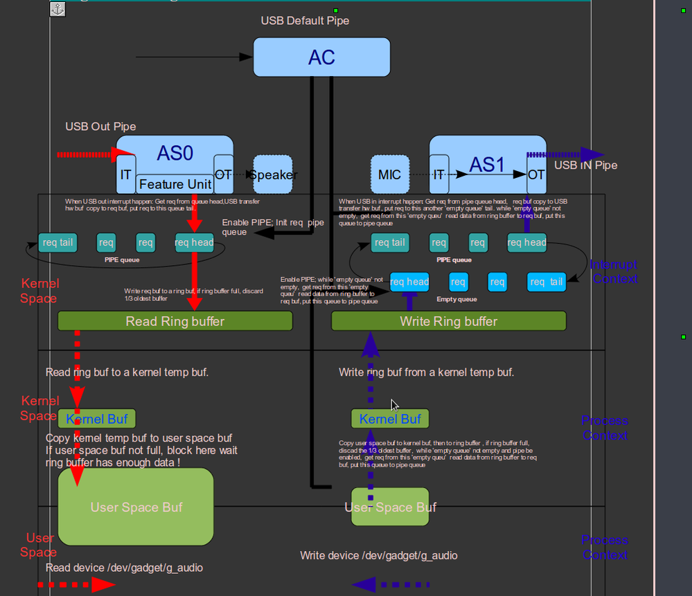

Below is one implementation of i.MX as a USB Playback/Capture device on one OTG port.
As file /dev/gadget/g_audio
file system : gadgetaudiofs_type

USB out pipe parameter:
Sample width hard code to 16bits.
static int out_sample_rate = 48000;
static int out_channel = 2;
#define OUT_EP_ALIGN (2 * out_channel) // 2 mean 2 bytes, sample width 16bits
OUT_EP_ALIGN mean “read ring buffer” write/read align, if read/write length not align this value, throw out error. Read mean user space read system call, write mean driver internal copy req->buf to “read ring buffer”.
#define OUT_EP_MAX_PACKET_SIZE (192) // out pipe max packet size, it based on out_sample_rate and out_channel. 192 = (48KHZ / 1000) * out_channel * sample_width(as bytes)
192 = (48000 / 1000 ) * 2 * 2;

static int out_req_count = 256; /* out pipe queue count, this value dose not introduce extra audio latency ! */
#define AUDIO_READ_RINGBUF_LEN (23 * OUT_EP_MAX_PACKET_SIZE)
/* 4416 bytes, max valid 23 * 192, about 23 ms at 48KHZ, this value determine out pipe max audio latency */
If “read ring buffer” full, how to handle continue write: discard the 1/3 oldest ring buffer.

USB in pipe parameter:
static int in_sample_rate = 8000;
static int in_channel = 2;
#define IN_EP_ALIGN (2 * in_channel) // 2 mean 2 bytes, sample width 16bits
IN_EP_ALIGN mean “write ring buffer” write/read align, if read/write length not align this value, throw out error. Write mean user space write system call, read mean driver internal copy “write ring buffer” to req->buf.
#define IN_EP_MAX_PACKET_SIZE (32) // in pipe max packet size, it based on in_sample_rate and in_channel. 32 = (8KHZ / 1000) * in_channel * sample_width(as bytes)
32 = (8000 / 1000 ) * 2 * 2;
Hear 1000 based on:
as_in_ep_desc.bInterval = 4;
/* 4 in hi speed as 2 exp (4 -1) = 8 uframe time, 8 uframe time is 8 * 125 us = 1ms 1000 = 1s / 1ms */
static int in_req_count = 32; /* in pipe queue count, this value dose introduce extra audio latency ! Latency = 32ms */
#define AUDIO_WRITE_RINGBUF_LEN (32 * OUT_EP_MAX_PACKET_SIZE)
/* 1024 bytes, max valid 32 * 32, about 32 ms at 8KHZ, this value and in_req_count determine in pipe max audio latency 32 + 32 = 64 ms*/
If “write ring buffer” full, how to handle continue write: discard the 1/3 oldest ring buffer.

Clock Sync issue of echo cancellation based on this implementation:
USB clock domain different with play back and microphone, some buffer will be discard by USB audio driver.
See this diagram:
1: Echo cancellation application will try best to read “USB Output Buffer”, so no buffer will be discarded from output. ( Application input and output based on the same clock).
2: “Host playback buffer” maybe overrun because:
A: Playback source unstable and host playback buffer not enough larger.
B: Clock(playback) quick than Clock(USB).
3: Echo cancellation application will try best to read “ALSA Buffer”, so no buffer will be discarded from “ALSA buffer”. (Application discard some samples of “ALSA Buffer”)
3: Echo cancellation application handle “USB Output Buffer” and “ALSA Buffer” based on “USB Output Buffer” that same time mean based on Clock(USB). We assume Echo cancellation application will insert or discard some samples of “ALSA Buffer” based on “USB Output Buffer”.
4: Echo cancellation application will send processed buffer to USB audio driver based on Clock(USB), so no buffer will be discard from “USB Input Buffer”.
If Echo cancellation application said “ I don't have the ability to insert or discard some samples of “ALSA Buffer”, we need adjust the Clock(MIC) based the internal buffer level of Echo cancellation application. But I think the “internal buffer level” will be influenced by difference of the clocks, the buffer input and output task runtime loading, so it may not be reality to implement this, need do more test on this!
