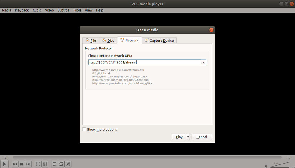

2. Video Test Source Example
Server
$ gst-variable-rtsp-server -p 9001 -u "videotestsrc ! v4l2h264enc ! rtph264pay name=pay0 pt=96"
Client
2. Camera Example
Server
$ gst-variable-rtsp-server -p 9001 -u "v4l2src device=/dev/video0 ! video/x-raw,width=640,height=480 ! v4l2h264enc ! rtph264pay name=pay0 pt=96"
Client
In order to use VLC or other application as the client, just enter the URL as shown in the image below:vlc_rtsp_example.png
