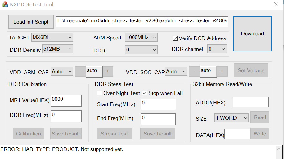

There are three options to run the DDR Stress test. Each of these options are provided in the attached zip files. The following is a high-level overview of each option along with the naming convention of the associated zip file:
Option 1 GUI based:
Run the GUI executable and connect your board to the host PC via USB
  • Archive file: ddr_stress_tester_vX.xx.zip
  • The tool will first need to run a DDR initialization script for the specified i.MX SoC (refer to Load Init Script in the GUI tool).  Example initialization scripts based on NXP's development boards can be found in this zip file under the script folder.  Note, these scripts may need to be modified for your custom board and memory.
Option 2 DDR Stress Tester: JTAG Interface
A hardware debugger connected to the board via the JTAG interface is used to download an elf file into the i.MX SoC OCRAM (internal RAM) and then begin execution. Results are shown on the UART serial port (115200-8-n-1).
  • Archive file: ddr_stress_tester_jtag_vX.xx.zip
  • As with the GUI tool, the JTAG/debugger option will first need to run a DDR initialization script for the specified i.MX SoC. Refer to the GUI tool description above for the location of the example scripts (which are found in the ddr_stress_tester_vX.xx.zip file).
  • Note that the scripts are available either in the RealView ICE format (.inc file) or the DS-5 DSTERAM format (.ds). For other debuggers, the user will have to modify the script's command syntax for their specific debugger. This is also true if converting from a RealView Ice (.inc) format to a DS-5 DSTREAM (.ds) format and vice versa.
  • The DDR Stress Tester executable (starting with V2.20) has an auto UART detection feature. If a different UART port for the serial console has been chosen than used on the NXP development tool (EVK, SABRE) specific commands can be added to the DDR initialization script that allows you to configure for the specific UART and then load and run the elf executable. Refer to the FAQ section of this community post and the txt file found in the JTAG archive file for instructions.

Q. I run DDR calibration using the DDR Stress Test Tool to obtain the calibration results.  Are these calibration parameters are written to the uboot flash_header.S automatically or manually?
A. The calibration values obtained from the DDR Stress Test Tool will need to be manually updated in the flash_header.S file or any other DDR initialization script.

I'm using the I.MX6ULL_DDR3_Script_Aid_V0.01 init script  and the ddr_stress_tester_v2.70 to perform calibration for the iMX6ULL SoC.
after calibration has finished,I recive 6 registers to update vlaues for:
MMDC registers updated from calibration
Write leveling calibration
MMDC_MPWLDECTRL0 ch0 (0x021b080c) = 0x00000000
MMDC_MPWLDECTRL1 ch0 (0x021b0810) = 0x00100010
Read DQS Gating calibration
MPDGCTRL0 PHY0 (0x021b083c) = 0x01380140
MPDGCTRL1 PHY0 (0x021b0840) = 0x00000000
Read calibration
MPRDDLCTL PHY0 (0x021b0848) = 0x40402A2A
Write calibration
MPWRDLCTL PHY0 (0x021b0850) = 0x40403E38
Success: DDR calibration completed!!!
the following 2 registers:
MPDGCTRL1 PHY0 (0x021b0840) = 0x00000000 (value is always 0)
do not appear in the I.MX6ULL_DDR3_Script_Aid_V0.01 init script nor do they appear in the register list
section "36.12 MMDC Memory Map/Register Definition" in the i.MX 6ULL Applications Processor Reference Manual,
and they do not appear also in NXP's board .cfg file:
http://git.freescale.com/git/cgit.cgi/imx/uboot-imx.git/tree/board/freescale/mx6ullevk/imximage.cfg?...
Reading their value in U-boot returns 0x0000000
are these registers part of the iMX6ULL calibration process or this is a bug of the tool?
I know they exist in other SoC but wanted to verify id they are not necessary and can be ignored
i've tried also v2.60 of the tool but result is the same
would appreciate your clarification,
Aviad
Hello Aviad,
6ULL only supports 16 bit bus width (Byte 0 and Byte 1). The registers you mentioned store the calibration values for write leveling and DQS gating for Byte 2 and Byte 3 - bytes that are used in wider bus widths (32 bit etc.) in other SoCs. So for 6ULL they have no meaning and the tool output is probably just an artefact when support for 6ULL was added in the tool and sources from previous SoCs were used.
OliverChen‌ could you please arrange for an update of the tool?

I use the DDR_Tester on my board use chip MCIMX6S5EVM10AC,but i get an error like the fllowing picture
