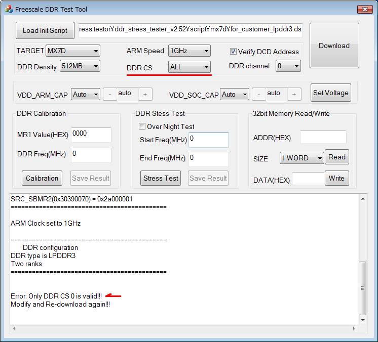

For the iMX 7D:
Because the MX7D DDR controller is different, the DDR stress test will need the user to supply the entire supported density found on their board. The chip select field should be left as is (0) as the test will naturally test one chip select to the next. For example, let’s assume you are using two chip selects, with each chip select being 512MB. In this case, you would enter 1GB for the DDR Density field ensuring that both chip selects will be tested. The user is allowed to enter a density less than the density found on their board (for quicker testing), but keeping in mind both chip selects may not be tested in this case.

Q. When running the DDR stress test on MX7D and I try to perform calibration, I get an error stating that calibration is not supported, is this expected?
A. Yes, calibration is not supported or needed when using MX7. The reason is, MX7 uses a different memory controller than the MX6 series. The MX6 series memory controller has built-in support for calibration where the MX7 memory controller does not.
Q. When running the GUI version of the DDR stress test, on MX7 and I leave DDR Density as default, I get an error in the tool stating I must supply a density. Why is this?
A. This is due to the fact that MX7 uses a different memory controller than the MX6 series. In the MX6 series, it was possible to calculate the memory density from the memory controller register settings. The MX7 memory controller is different and does not lend itself to easily calculate the supported density based on the register settings. Instead, the user should verify the density on their board and selected this value in the DDR Density pull-down menu.

Dear Oliver,
* I sent this question to TIC, But they recommended me to post here.
We are developing the product using i.MX7D currently.
And we have the prototype board now.
Our board uses one LPDDR3 (32 bit, 4Gb+4Gb Dual-dai/2-RANK type).
We use ddr_stress_tester_v2.52.
Because LPDDR3 which they use has two chip selects, I choose CS-ALL as the attached image, but Error is displayed in the log window and it cannot perform stress test.
When choosing Density-1GB and CS-0, stress_tester work fine and its result is also good.
I think that only one area of two chip selects can be tested in this condition.
How should I understand this condition?
a) Can't the stress tester handle two CS, when using LPDDR3?
b) Are we mistaken in something?
George
- Mark as Read
- Mark as New
- Bookmark
- Permalink
- Report Inappropriate Content
George,
I saw a similar issue and here’s what I got back from the factory:
The MX7D DDR controller design is different than the DDR controller found in the MX6 series. The DDR stress test is able to parse the MX6 series DDR controller (called the MMDC) settings to ascertain things like density and number of chip selects and as such is able to distinguish one chip select from another, allowing a user to test only one chip select in a two chip select design.
In your case, you have 1GB total, or 512MB per chip select. When the stress test runs, as it tests the end of the first 512MB it moves onto the next 512MB, and the chip selects will automatically assert depending on which 512MB density of memory is being tested. In this case, by supplying 1GB as your density, you are ensured that both chip selects are being tested.
I’ll see if the factory can add this as part of the FAQ above.
