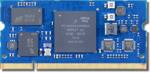

The i.Core M6SX is the latest powerful i.MX6 SoloX based SOM solution provided by Engicam in SODIMM format.
The i.MX 6SoloX is the first device utilizing both the ARM Cortex-A9 and ARM Cortex-M4 cores.
Its heterogeneous architecture provides a secure and robust implementation to enable concurrent execution
of multiple software environments to provide an application-rich system with real-time responsiveness.
Optimized for high performance energy efficient processing in general embedded, automotive,
industrial and consumer applications
i.CORE M6SX
Cores
  • Cortex TM -A9 @ 800 MHz core, NEON co-processor. DP FPU, L1 and L2 I/D cache
  • Cortex TM -M4 @ 200 MHz core SP Floating point unit,  I/D chache
Memories
  • 256MB 32bit DDR3-800
  • 512MB SLC NAND Flash
Graphics and Multimedia
  • 1x Parallel LCD 18bit output
  • 1x LVDS output
  • Hardware 3D/2D engine OpenGL-ES 2.0 and OpenVG1.1
  • Parallel Camera Interface input
  • Touch screen
Peripherals
  • 2x SD Card interface
  • USB OTG HS, USB HS HOST, Uart, I2C, I2S, QSPI,PCI Express
  • SATA ADC and Video ADC input
  • 2x Ethernet 10/100
Dimensions
  • Standard SODIMM footprint 67,4x31.9 mm PCB size
  • Very Low Profile Module
