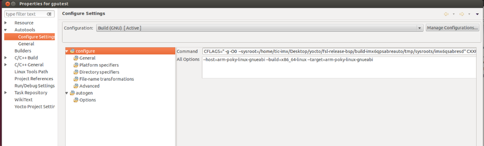

  • ​    Add the PATH to CFLAGS where the compiler will look for the headers at Project->Properties->Autotools->configure:
          In this project there is no need to add extra PATHs for the headers.
  • Apply the changes by clicking on Reconfigure Project.

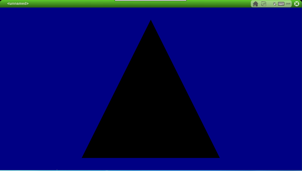

  • To test the file you can send the executable to the board with:
     $ scp gputest root@<board_ip>:/home/root
     $./gputest
     You should get the next output in the display:
          For this example the next lines are added
       -I${Sysroot}/usr/include/gstreamer-1.0
       -I${Sysroot}/usr/include/glib-2.0
       -I${Sysroot}/usr/include/libxml2
       -I${Sysroot}/usr/lib/glib-2.0/include
