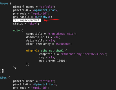

Step-1 Make the dts change to enable wake-up functionality on eth1
In the following dts:-
arch/arm64/boot/dts/freescale/imx93-11x11-evk.dts
You would see the node entry for the corresponding ethernet, eth1 as eqos.
Add fsl,magic-packet; to the node
After building the changes, boot with the imx93evk image.

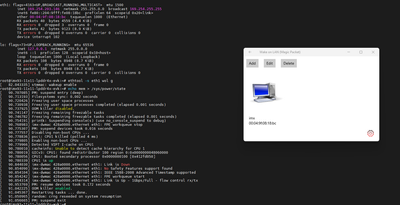

Step-2 Enable wake on LAN
By default in linux user-space the wake-on-lan is disabled, to enable the wake-on-lan run:
 ethtool -s eth1 wol g
Now you are all set to wake up imx93evk via Ethernet WOL packet.
Put the iMX93 to deep sleep via 'echo mem > /sys/power/state'
Step-3 Send WOL magic packet via Wake On LAN windows utility to wake up iMX93EVK
Make sure the devices are connected to the same local network like imx93evk and laptop connected to the same L2 switch.

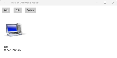

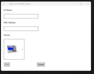

Add your imx93evk device to Wake on LAN software, you have to give iMX93EVK's MAC address of the ethernet that the RJ45 cable is connected to[you can get this from 'ifconfig -a' output].
After adding the device, it will look something like below:-
Right-click on the 'imx' device which is registered on Wake on LAN UI and click on 'Send WOL(magic packet)'.
The moment you do that the WOL packet is sent to your iMX from your Laptop/PC on the same network and the iMX is woken up from deep sleep.
