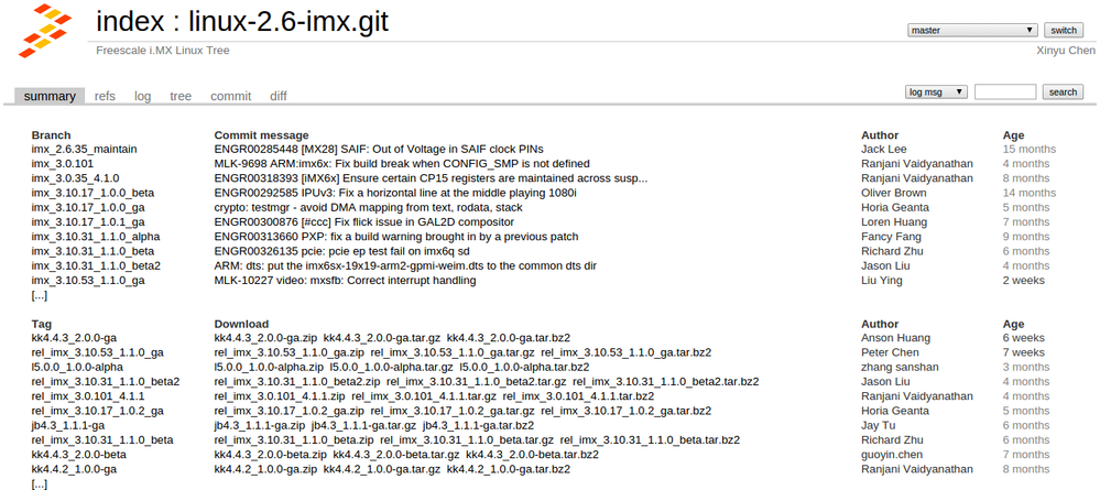

The Freescale i.MX Linux source base is available in a GIT repository, visible using your favorite web browser at this link:  Freescale i.MX Linux Tree<http://git.freescale.com/git/cgit.cgi/imx/linux-2.6-imx.git/> or you can utilize the GIT “clone” feature and make a copy locally:
$ git clone git://git.freescale.com/imx/linux-2.6-imx.git.
NOTE: The repository name is linux-2.6-imx.git, but contains all Linux GA releases, 3.0, 3.10, etc.
Here is a snapshot of the current web view:
When Freescale issues a Linux GA release, a GIT Tag is applied to snapshot the code. The Linux naming convention:

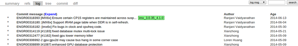

The GIT Branch tree is used for patches. As changes are found and deemed necessary for a release, a GIT commit is pushed to the Branch. The Linux naming convention:
imx_3.0.35_4.1.0
imx – notice only imx and not rel_imx.
3.0.35 – the Linux Kernel Version
4.1.0 – Freescale Version
With each patch commit the Branch name is always found at the most recent commit.

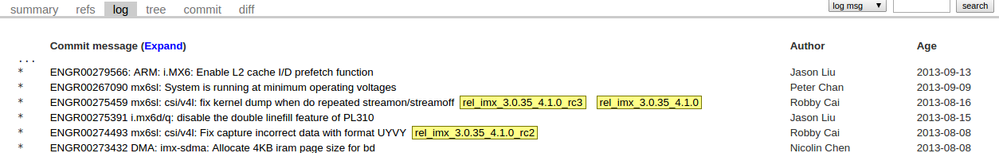

Let’s look at the Web view, you will see the Branch name and also the Tag release name. I have removed some of the commits to show a condensed view here:
From the picture above, the Yellow box: rel_imx_3.0.35_4.1.0 is the commit point that matches what is found in the Board Support Package (BSP) release. The green box imx_3.0.35_4.1.0 is the latest patch available for this release.
I would recommend applying all the patches available on the Branch of your BSP release.
