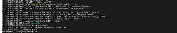

3. Put A55 core to deep sleep and trigger a wakeup from M33 console
To put A55 to deep sleep
echo mem > /sys/power/state
you will see something like below on linux console:-
At this point, A55 core is in deep sleep power saving mode. So the A55 console will not respond to any of the key presses. Go on, give it a try
Now to wake up this core, go to M33 serial console and type 'W'
This will wake up A55 core and you will see the logs denoting that the core has woken up:-
That's it! that's how you exercise UART wake-up functionality on imx93evk. Please feel free to drop any follow-up questions or additional thoughts on this.
