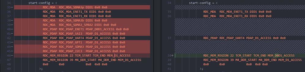

2. Modify Uboot
arch/arm/dts/imx8mp-evk-u-boot.dtsi
The RDC will assign SAI3, sdma3 and i2c3 to M7 when M7 start. So we need to delete these lines.

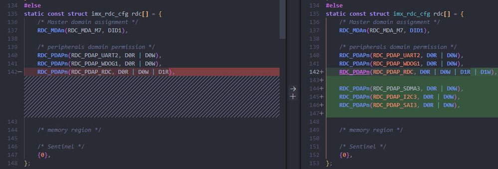

3. Add RDC config in ATF
plat/imx/imx8m/imx8mp/imx8mp_bl31_setup.c
 Assign SAI3, sdma3 and i2c3 to A53.

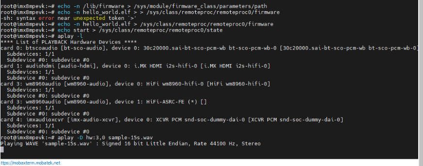

Result
We can play audio on wm8960 after we load M7 firmware.
