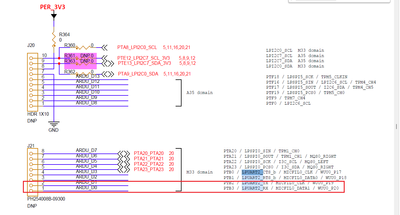

Some customer want to use LPUART2 in DSP domain on M33 core. This patch is based on lpuart_edma example.
Hardware test point:
You will get such log from LPUART2 if we enter 3 on keyboard
