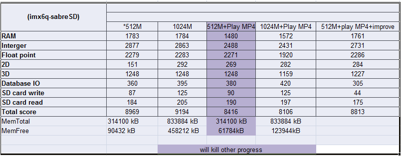

How to Modify U-boot configure for change memory size to 512M
Only need change the u-boot memsize configure.
     #define PHYS_SDRAM_1_SIZE
                  (1u * 512 * 1024 * 1024)
Use the performance tool Antutu test system in 512M and in 1024M.

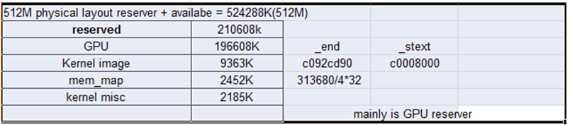

     * The statistic of Memory free after each test.
    * The improve test is reduce GPU reserve physical memory size from 192M to 128M
System boot-up reserve. (Static)

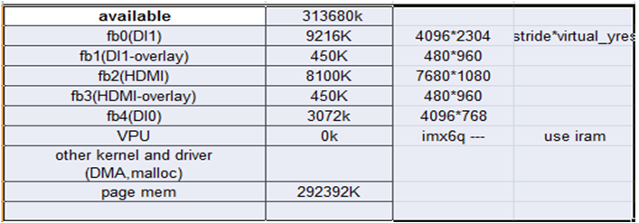

DMA allocate page and mem page.(Dynamic)
Use for page alloc  < 292392K
Browser speed
    * The Browse speed in 512M is nearly with in 1024M
Conclusion:
  It is acceptable for this performance when use 512M physical memory.
