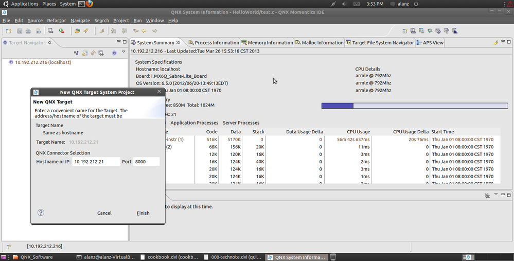

Part 4. Debug w/ QNX Momentics IDE
       4.1 Type "qde" to activate Momentics IDE
       4.2 On the top-right corner, there exist several icons named in "xxx perspective" to switch the main window according to current selected "perspective" context. Click "QNX System Information Perspective" to create a target to conect and debug as following depicted.

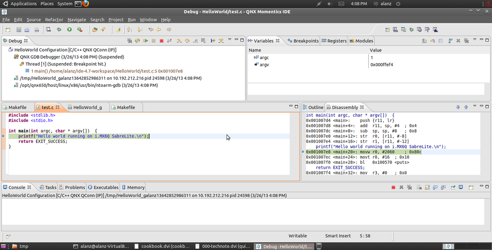

       4.4 Switch to "Debug perspective" to perform "Debug Configuration" as following depicted.
       Then it can debug program on target i.MX6Q SabreLite board.
