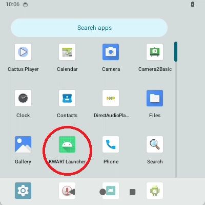

3. Install the APK
  • Install the APK
    • Android studio
      • Run the app like regular.
    • Android SDK
      • Reflash the SDK images and the app will occur after boot finishes.
  • Then you will find the following APP.
