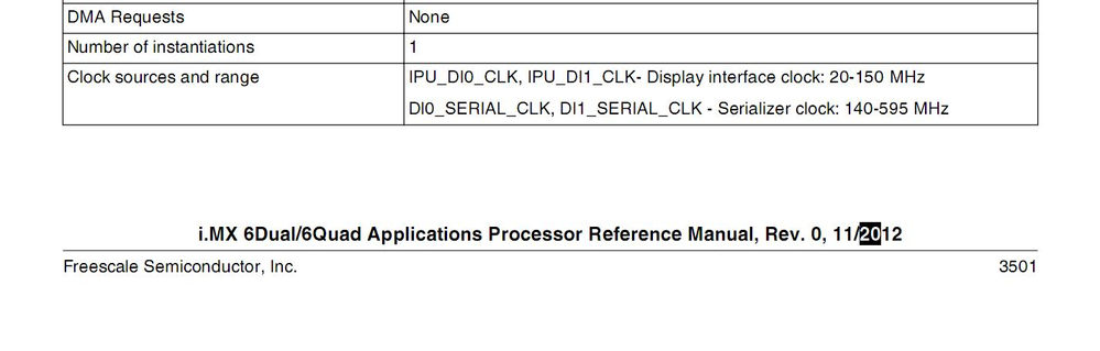

Some customers often use LVDS LCD with low resolution on i.MX6 platform, such as 320x240, but by defualt , linux bsp doesn't support low frequency pixel clock for LVDS module input.
Question:
    When we port LVDS LCD with 320x240 resolution to android4.2.2, we found pixel clock is not correct, it always output 38.9MHz, it is no probem for big resolution , for example 1024x768, but the clock we need for 320x240 LCD is 6.4MHz.

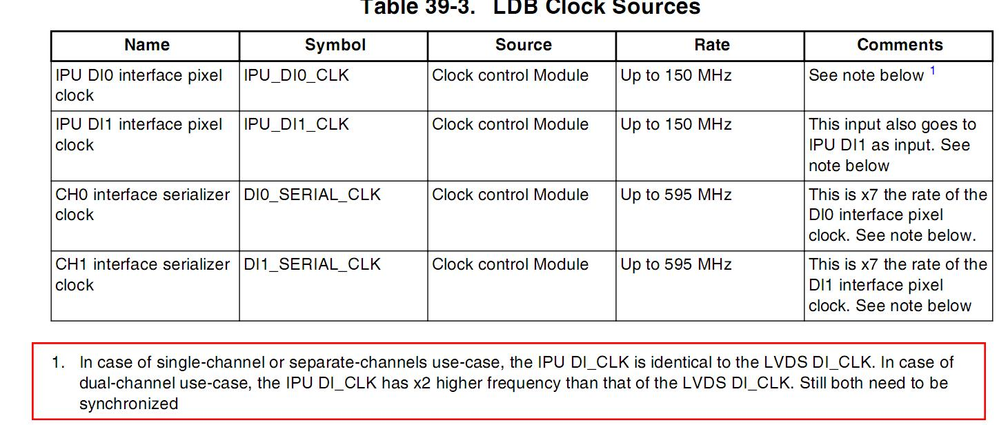

    According to the quesiton, Let us check IPU & LDB clock in i.MX6 datasheet at first :
From above table, if ldb clock is from IPU, we will not get 6.4MHz pixel clock, so we will have to adjust its source clock:
The following steps are procedure that ports LVDS LCD with 320x240 resolution to i.MX6Q.

2.Modifying clock source of ldb module
Checking /arch/arm/mach-mx6/clock.c, we can find there are 3 ldb's clock source : &pll5_video_main_clk, &pll2_pfd_352M, &pll2_pfd_400M,
static int _clk_ldb_di1_set_parent(struct clk *clk, struct clk *parent)
       u32 reg, mux;
       int rev = mx6q_revision();
       reg = __raw_readl(MXC_CCM_CS2CDR)
              & ~MXC_CCM_CS2CDR_LDB_DI1_CLK_SEL_MASK;
       mux = _get_mux6(parent, &pll5_video_main_clk,
              (rev == IMX_CHIP_REVISION_1_0) ?
               &pll3_pfd_540M :       /* MX6Q TO1.0 */
               &mmdc_ch1_axi_clk[0],     /* MX6Q TO1.1 and MX6DL */
              &pll3_usb_otg_main_clk, NULL);
       reg |= (mux << MXC_CCM_CS2CDR_LDB_DI1_CLK_SEL_OFFSET);
       __raw_writel(reg, MXC_CCM_CS2CDR);
       return 0;
By default, pll2_pfd_352M is configured as the clock source of ldb:
clk_set_parent(&ldb_di0_clk, &pll2_pfd_352M);
       clk_set_parent(&ldb_di1_clk, &pll2_pfd_352M);
We should change the clock source to be pll5_video_main_clk
clk_set_parent(&ldb_di0_clk, &pll5_video_main_clk,);
       clk_set_parent(&ldb_di1_clk, &pll5_video_main_clk,);
