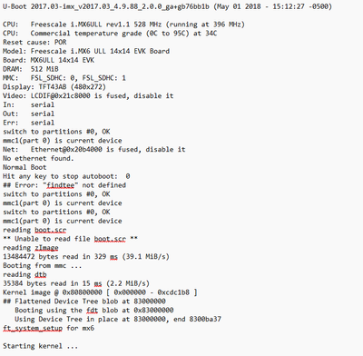

Our customers encounter Kernel stuck at starting kernel issue. Here is detail description as below:
(1 )Using customer board, and the main chip is MCIMX6Y1DVM05AB.
(2) MCIMX6Y2CVM05AB works fine using the same image.
(3)The kernel version is L5.10.52. But the old L4.14.98 works fine.
(4)Using imx6ull evk's dtb has the same symptom. (imx6ull-14x14-evk.dtb in L5.10.52 prebuild image from NXP.
(5)The  L4.14.98 versionBSP
both  MCIMX6Y1DVM05AB and MCIMX6Y2CVM05AB can work well
For the L5.10.52 only the MCIMX6Y2CVM05AB can work.
Kernel crash at here:

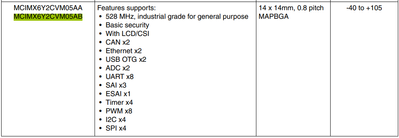

For these two products, they are difference, but most pins to pins in design.
1\Found the difference for this two product:
See the datasheet:
https://www.nxp.com.cn/docs/en/data-sheet/IMX6ULLCEC.pdf
https://www.nxp.com.cn/docs/en/data-sheet/IMX6ULLIEC.pdf

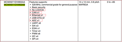

For the MCIMX6Y1DVM05AB do not have the LCD/CSI, one CAN, one Ethernet,one ADC.

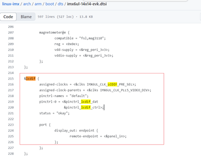

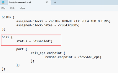

The MCIMX6Y1DVM05AB chip has only followed features, so customer should make sure the related drivers are removed from dts. That means in climaxL5.10.52.7z, customer should disable the followed drivers: pxp, lcdif, can2. (csi and fec2 are already disabled)
(1) Disable the fec2
(2)CSI disable
(3)Lcdif disable

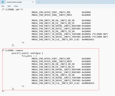

(4)CAN 2 Remove
Result:
After remove these unused functions. The MCIMX6Y1DVM05AB could boot well on customer’s board.
