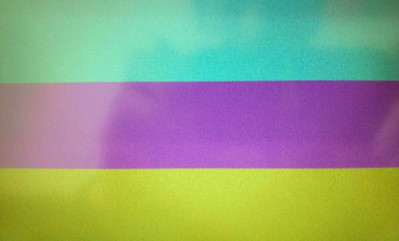

Hi Qiang,
After checking the pixel color carefully, I found the pixel color was reversed when displayed in uboot. For example, if the pixel data in display buffer is Red (0xFF0000), the acutal display result is 0x00FFFF (Green + Blue). However after kernel and Android boots up (with logo smooth transition feature), the color becomes correct!
I did a test by changing
#define DISPLAY_DATA_POLARITY     0
to
#define DISPLAY_DATA_POLARITY     1
After this change the color in uboot looks correct but it is reversed after kernel and Android boots up. However the color in Android will be correct after the system wakes up from sleep. I guess there is IPU re-initialization during wakeup.
Perhaps I can workaround this issue by reversing pixel data in uboot display buffer before it is displayed, but don't know why there is such issue.
I also checked ipu_iomux_config() and it looks no problem.
Please note in my case DISPLAY_IF_BPP  is set to 24. If DISPLAY_IF_BPP  is set to 16, the color in either uboot or Android is incorrect unless the system wakes up from sleep.
The POLARITY of VSYNC, HSYNC, Pixel clock, data, DE depend on your panel's datasheet.
You should double check them and the same setting should be used in kernel and Uboot. Your issue is more like pixel clock polarity issue.
