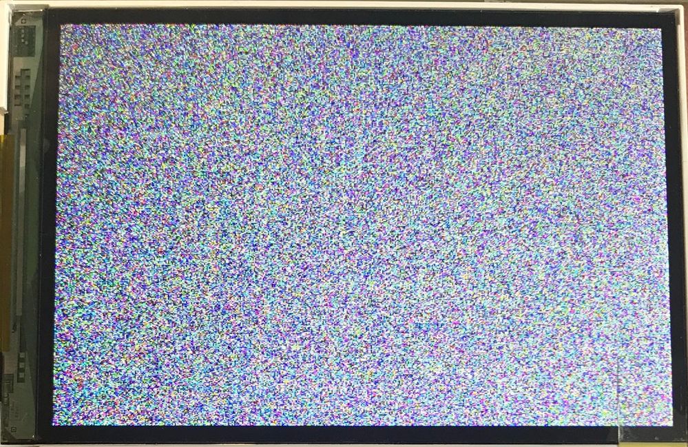

we need to port the Yocto Project BSP to a custom board based mainly on imx6ul evk.
Our board includes a 16bit TFT display with a SITRONIX ST7789V controller.
We are working with the following BSP version: fsl-yocto-L4.1.15_2.0.0-ga.
We tried to apply the patch to this kernel, but the LCD shows images on only one quarter of the total area, but the resolution is the same 240x320, and the colors appear not correctly.
The only modification with respect of the above patch was that in the mxsfb_st7789s_qvga.c source files, because we have 16 bit (16 LCDIF_DATA pins) connected to the display.
static struct mpu_lcd_config lcd_config = {
.bus_mode = MPU_BUS_8080,
.interface_width = 16,
.panel_bpp = 16,
We also change the dts to use 16 bit LCD DATA bits:
pinctrl_lcdif_dat: lcdifdatgrp {
fsl,pins = <
MX6UL_PAD_LCD_DATA00__LCDIF_DATA00 0x79
MX6UL_PAD_LCD_DATA01__LCDIF_DATA01 0x79
MX6UL_PAD_LCD_DATA02__LCDIF_DATA02 0x79
MX6UL_PAD_LCD_DATA03__LCDIF_DATA03 0x79
MX6UL_PAD_LCD_DATA04__LCDIF_DATA04 0x79
MX6UL_PAD_LCD_DATA05__LCDIF_DATA05 0x79
MX6UL_PAD_LCD_DATA06__LCDIF_DATA06 0x79
MX6UL_PAD_LCD_DATA07__LCDIF_DATA07 0x79
MX6UL_PAD_LCD_DATA08__LCDIF_DATA08 0x79
MX6UL_PAD_LCD_DATA09__LCDIF_DATA09 0x79
MX6UL_PAD_LCD_DATA10__LCDIF_DATA10 0x79
MX6UL_PAD_LCD_DATA11__LCDIF_DATA11 0x79
MX6UL_PAD_LCD_DATA12__LCDIF_DATA12 0x79
MX6UL_PAD_LCD_DATA13__LCDIF_DATA13 0x79
MX6UL_PAD_LCD_DATA14__LCDIF_DATA14 0x79
MX6UL_PAD_LCD_DATA15__LCDIF_DATA15 0x79
Have you, some ideas to fix this?
Thanks in advance for any helpful answer.

Hi Francesco, although you are using the same controller st7789, but the initialization for each panel is not same, you need check with your panel vendor and update the code in mpu_st7789s_lcd_setup().

I updated the code according to panel vendor indications in this way:
int mpu_st7789s_lcd_setup(struct mxsfb_info * mxsfb)
if (mxsfb == NULL)
return -1;
/* Sleep out */
mxsfb_mpu_access(mxsfb, MPU_CMD, MPU_WRITE, 0x11);
//------------------------------display and color format setting--------------------------------//
mxsfb_mpu_access(mxsfb, MPU_CMD, MPU_WRITE, 0x36);
mxsfb_mpu_access(mxsfb, MPU_DATA, MPU_WRITE, 0x00);
mxsfb_mpu_access(mxsfb, MPU_CMD, MPU_WRITE, 0x3a);
mxsfb_mpu_access(mxsfb, MPU_DATA, MPU_WRITE, 0x06);
//--------------------------------ST7789S Frame rate setting----------------------------------//
mxsfb_mpu_access(mxsfb, MPU_CMD, MPU_WRITE, 0xb2);zImage-sd

I'm using this patch for imx6ul and ili9488 smart based lcd, using 320x480 resolution 16 bit bus with 16bpp. It seems something is not right.
Picture is one 1/4 of display area, multiplied 4 times. Line length is 960 if I debug code..odd.
Is this patch fully working for this kind of platform?
Br, Juha

Thanx!
I also found that on void mxsfb_mpu_setup_refresh_data(struct mxsfb_info *host)
must be commented out:
#if 0
if (host->mpu_lcd_sigs->panel_bpp == 16) {
writel(CTRL_YCBCR422_INPUT |
(1 << CTRL_INPUT_DATA_SWIZZLE_OFFSET),
host->base + LCDC_CTRL + REG_SET);
#endif
after this lcd is ok and working.
Next I try to change panel from async to sync (using vsync and hsync) on a fly
Br,JPO
- Mark as Read

Hi Joe,
I have tried your suggestions however still I could not make the TFT work. I wonder what were the specs of your TFT display and which root file system you have used. For example my TFT is 16-bit wide data interface, 18bpp, 320x480 resolution and I am using a custom root file system. Kernel version is 4.1.15_2.0.0_ga
I have checked that the CONFIG_VIDEO is not defined in the U-Boot source. The processor boots but when I run the unit test for the framebuffer, the processor freezes, by the way I get such a display
I will try to implement your patches into 4.9.11 kernel to check if it works.
- Mark as Read
- Mark as New
- Bookmark
- Permalink
- Report Inappropriate Content
Finally the display is working. The problem was related to the init code of the TFT, make sure you send the correct initialization code to the TFT panel. Also make sure the hardware configuration for interface selection (MPU, RGB, SPI, etc.) is correct.
If you see multiple images at the same time on the display, correct the TFT resolution variables from the driver code itself. Probably the x and y resolutions is entered in the reverse order.
Good luck!
