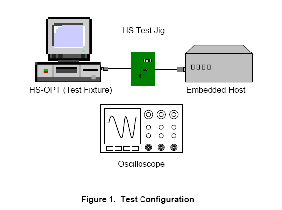

According to EHSET_v1.01.pdf description (http://testusb.com/EHHS.html), the USB physical certification test are from 2 sides. One test case is PC running USB-IF HSET utility as being USB host to test the target board being USB device; the other case is target board acting as USB host to initate test signals to a test fixture.
The principle of test modes supported are based on Vid/Pid pair  during enumration by host whoever takes.
Apply the attached patch (I use r13.4.1 kernel_imx tree), then enable "FSL_USB_TEST_MODE" in kernel config, rebuild uImage to get the test modes support kernel.

Good morning, Shimoda San,
     Linux does not need any patch but there are commands directly changing register content in order to generate USB TEST pattern and they work on L3.0.35_4.1.0:
            1 ./memtool -32 0x020c4080 1  (to read current value; for example, 0xc00)
            2 ./memtool -32 0x020c4080=(current value + 0x3; for example, 0xc03)
            3 ./memtool -32 0x02184140=0x2
4 ./memtool -32 0x021841A8=0x3
5 ./memtool -32 0x02184184=0x1C040000  ( * for some reason, first assignment does not generate test pattern. In this case, redo this command.)
     However, in my case running on Yocto, the 5th command changes bit0 and 1 of 0x020C4080 from 1 back to 0. So, we have to run 2nd command to set clock once more; otherwise, any following command could cause system crash. While I have submitted this issue to our internal team for help, you may try these commands on L3.0.35_4.1.0.
Wilson
