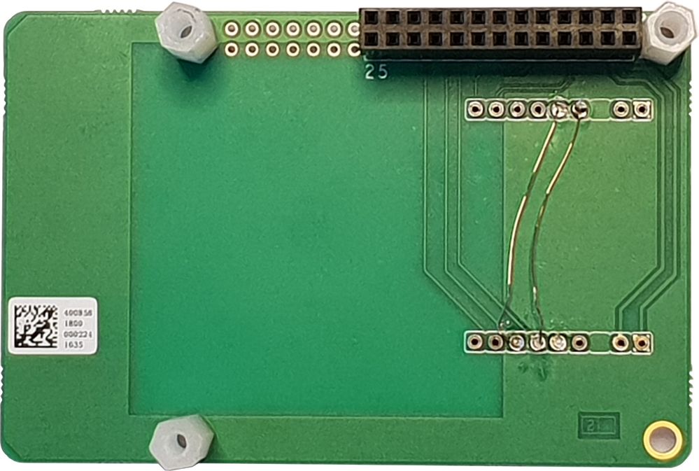

The i.MX8M mini evk (see i.MX 8M Mini Evaluation Kit | NXP) featuring Raspberry Pi compliant connector, the OM5578/RPI PN7150 demo kit can be used to perform this porting (see NFC Development Kits for Arduino and more|NXP). However a small modification must be done because some of the signals required by PN7150 are not mapped to i.MX8M mini expansion connector pins.
OM5578 IRQ signal must be mapped to Raspberry Pi connector pin #19 and OM5578 IRQ signal must be mapped to Raspberry Pi connector pin #21.
See below a picture of the modification:

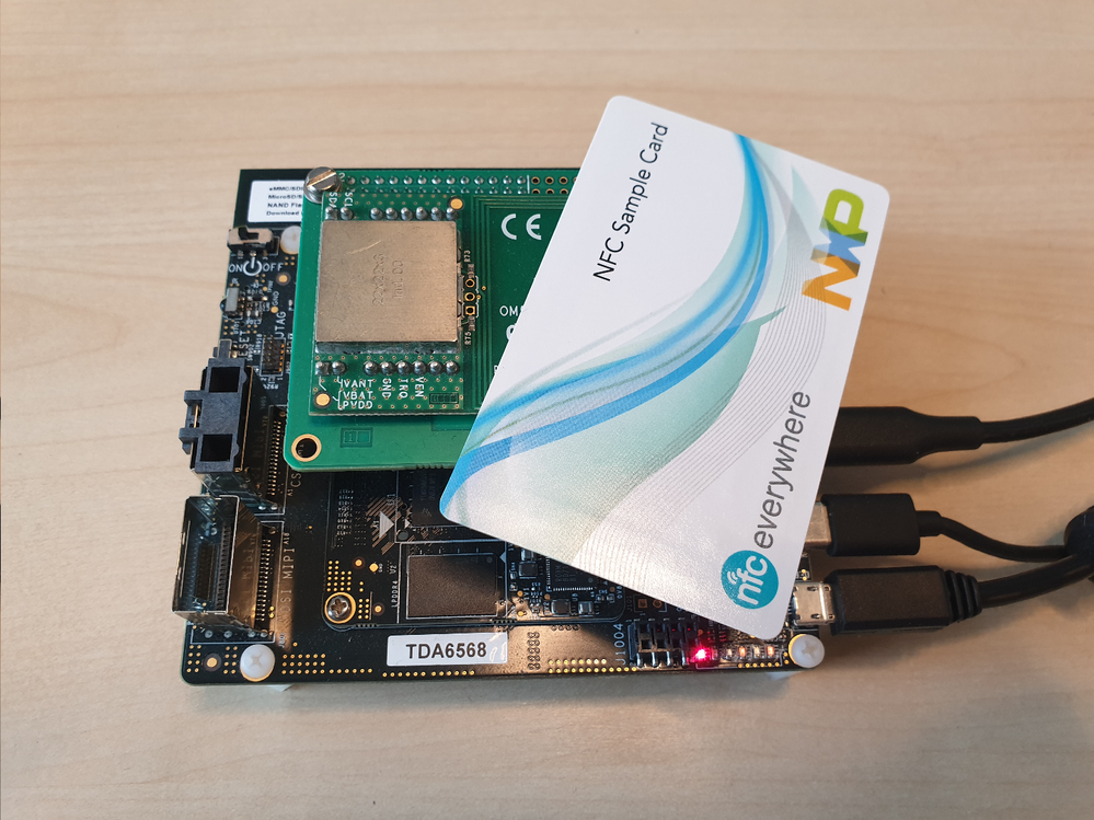

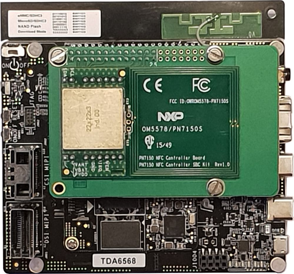

Then, the two boards can fit together as shown in the picture below:

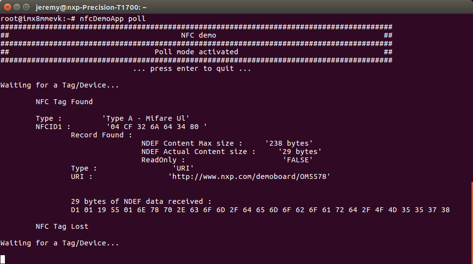

Then in a terminal you can run the demo application included in the image executing the command:
   # nfcDemoApp poll
Approaching the NFC tag, provided as reference in the OM5578 demo kit, to the NFC Antenna will trigger such display:
