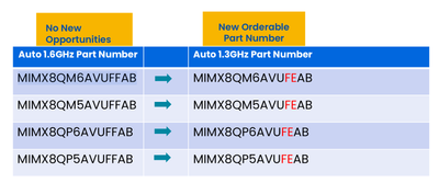

The i.MX 8QM and i.MX 8QP has been revised with lower clock speeds and higher core voltages to help improve instability issues found with the part. Old parts that have not been derated have an "FF" moniker in the part number, whereas new parts, releasing in June 2024, have an "FE" moniker. An example can be found below.
SCFW (System Controller Firmware) 1.16.0, which will be released with the Q2 Linux Factory BSP (LF6.6.y_2.0.0), will make the necessary changes to increase core voltage for CPU and GPU cores in the 8QM/8QP, as well as reduce clock speeds.
