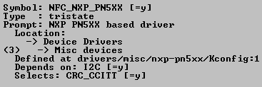

  2. Add the below line in the Makefile of the current directory
    obj-y += nxp-pn5xx/
  3. Include the driver config in the drivers/misc/Kconfig file
    source "drivers/misc/nxp-pn5xx/Kconfig"
  4. Export the environment variables
    $ source source /opt/poky/1.7/environment-setup-cortexa9hf-vfp-neon-poky-linux-gnueabi
    $ export ARCH=arm
    $ export CROSS_COMPILE=$TARGET_PREFIX
    $ make imx_v7_defconfig
  5. Using menuconfig include the driver as module (<M>).

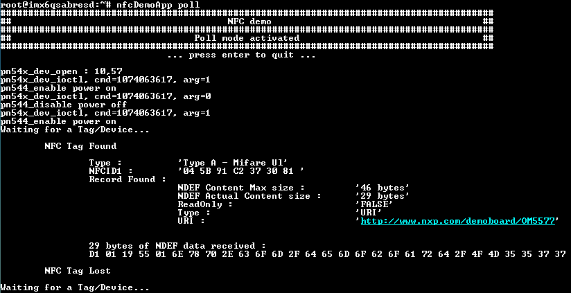

6. TESTING NFC READER
To test the application you have to follow the below steps on the target:
  1. Install the .ko file
    $ insmod /lib/modules/3.14.28+g91cf351/kernel/drivers/misc/nxp-pn5xx/pn5xx_i2c.ko
  2. Run the nfcDemoApp
    $  nfcDemoApp poll
    You should get a console output like the shown below when placing a NFC tag next to the NFC reader.
