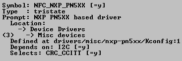

According to the AN11697.pdf we must follow the below steps:
  1. From the Linux source directory:
    $ cd drivers/misc
    $ git clone https://github.com/NXPNFCLinux/nxp-pn5xx.git
  2. Add the below line in the Makefile of the current directory
    obj-y += nxp-pn5xx/
  3. Include the driver config in the drivers/misc/Kconfig file
    source "drivers/misc/nxp-pn5xx/Kconfig"
  4. Export the environment variables
    $ source source /opt/poky/1.7/environment-setup-cortexa9hf-vfp-neon-poky-linux-gnueabi
    $ export ARCH=arm
    $ export CROSS_COMPILE=$TARGET_PREFIX
    $ make imx_v7_defconfig
  5. Using menuconfig include the driver as module (<M>).
  6. Compile the modules and install the .ko files into the target rootfs.
    $ make  modules
  7. You can send the .ko files with scp
    $ make  INSTALL_MOD_PATH=~/Desktop/modules modules_install
    $ cd ~/Desktop/modules
    $ sudo scp -r lib/modules/3.14.28+g91cf351/kernel root@<board_ip>:/lib/modules/3.14.28+g91cf351/

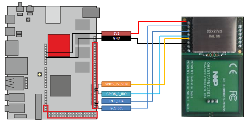

4. DEVICE NODE
The PN7120 interfaces with an MCU or MPU via I2C interface, therefore the device must be described into a i2c node. The signals used in the PN7120 are shown below:
As you can see besides power, ground and I2C lines, an IRQ and Reset pins are needed. These pins must be configured as GPIO and one must generate an interrupt to the iMX6Q.
The chosen connection is shown below:
To achieve the above configuration, the device tree must be changed. The changes consist on adding a device node in the corresponding I2C bus, describing the PN7120.

Okay, I see you use NXP PN7120A0EV, so you need check your hardware write first
The article use GPIO5_IO22 to enabled all regulator
you need to check your hardware how to wiring connecting the to  modify you driver and device tree file
