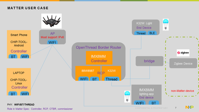

It is a Matter Demo setup guide to set up Matter OTBR on i.MX MPU Platfrom.
i.MX 2023Q2 release is based on Matter v1.1
 Current test solutions.
  • i.MX6ULL + 88W8987(WiFi-BT combo Module) + K32W(OpenThread RCP module)
  • i.MX8MM + 88W8987(WiFi-BT combo Module) + K32W(OpenThread RCP module)
  • i.MX8MM + IW612-RD-EVK (WiFi-BT-Thread tri-radio single-chip module)
  • i.MX93 + IW612 (WiFi-BT-Thread tri-radio single-chip module)
Matter Zigbee Bridge  https://community.nxp.com/t5/i-MX-Processors-Knowledge-Base/Matter-Zigbee-Bridge-base-on-i-MX-MPU-an...
if use imx8mm_k32w_matter.sh or imx93_matter.sh to setup OTBR, you need modify "SSID" and "
WIFI_PWD" in the script.
