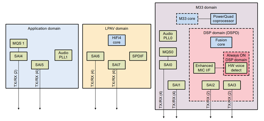

i.MX8ULP audio subsystem.
i.MX 8ULP extends audio capabilities on i.MX 7ULP by adding dedicated DSP cores for voice trigger and audio processing, enabling lower latency and power efficiency to support variety of audio applications.
Some of hardware blocks implemented on 8ULP to support audio use cases are the next:
  • Cadence Fusion F1 DSP processor.
  • Cadence HiFi4 DSP processor.
  • PowerQuad hardware accelerator with fixed and floating + FFT.
  • Digital Microphone interface with support of up-to 8 PDM channels.
  • Up-to 8 independent SAI instances.
  • Up-to 2 Medium Quality Sound (MQS).
  • Sony/Philips Digital interface (SPDIF).
As is described before, MQS0 and MQS1 are part of real time domain and application domain respectively. I’m going to focus this post on how to enable MQS1 on application domain.

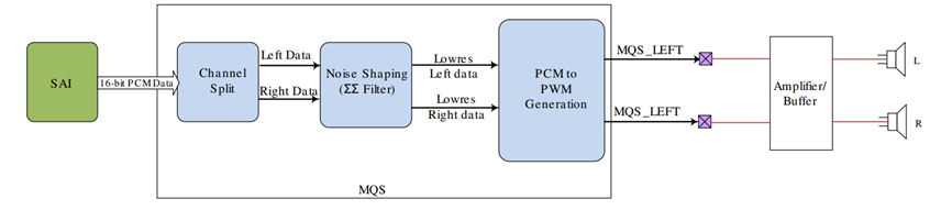

 This module is basically generates a PWM from PCM audio data. For the major part of typical audio applications will require an external CODEC to deliver the audio quality but, sometimes where the application does not demand this quality, MQS can provide a medium quality audio via GPIO pin that can directly drive the audio output to a speaker or headphone via inexpensive external amplifier/buffer instead of CODEC.
The design of the MQS can be described as follows:
  1. Input the PCM audio data (from SAI) into a 16-bit register.
  2. Up-sample data to match PWM switching frequency.
  3. Perform a simple 2nd order Sigma-Delta smooth on the current data versus previous data.
  4. Convert the PCM register into a 6-bit PWM width register and output through a GPIO pin.

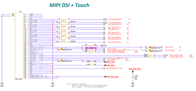

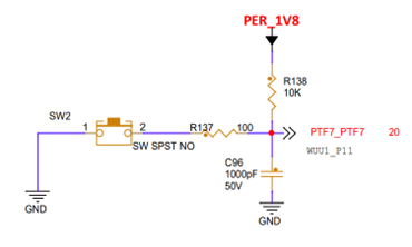

i.MX8ULP EVK limitations

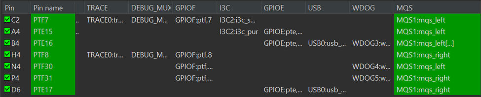

The i.MX8ULP has the next MQS1 pins available:
But, in the EVK board, the mayor part of these pins are used for other functions such as:
- Push button:
- MIPI DSI:
 - Etc…
So, take the output signal of MQS1 pins of EVK board is difficult, in this article, I’m going to configure PTF7 only (MQS1_left) for practicality. If you are working with this board and you need to use these pins for MQS function you will need to manipulate the traces and take the required signals. If you are designing a custom board, planning is essential to avoid this issue.

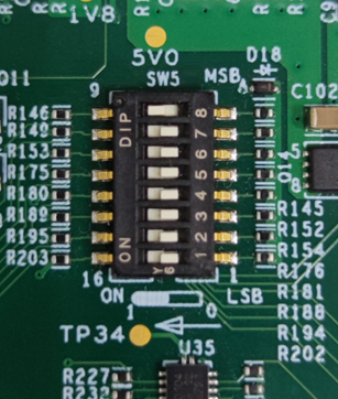

First, put the board in serial download mode changing the boot configuration switches on the board:
The next step is connecting the power cable, micro-USB cable on the debug port and USB-C type cable to USB0 connector on the board.

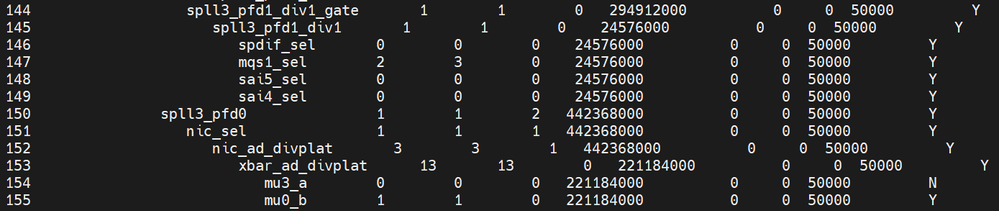

Now we can test MQS1 on i.MX8ULP EVK, let's confirm that the clock is active in MQS module with the next command:
$ cat /sys/kernel/debug/clk/clk_summary -n
As you can see mqs1_sel is active and running at 24576000 Hz:

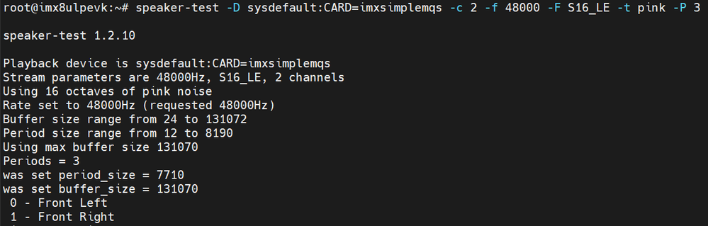

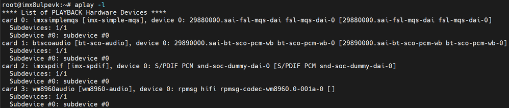

And the card appears if we run the next command:
$ aplay -l
To play audio through MQS we can do it as any sound card:
$ speaker-test -D sysdefault:CARD=imxsimplemqs -c 2 -f 48000 -F S16_LE -t
pink -P 3

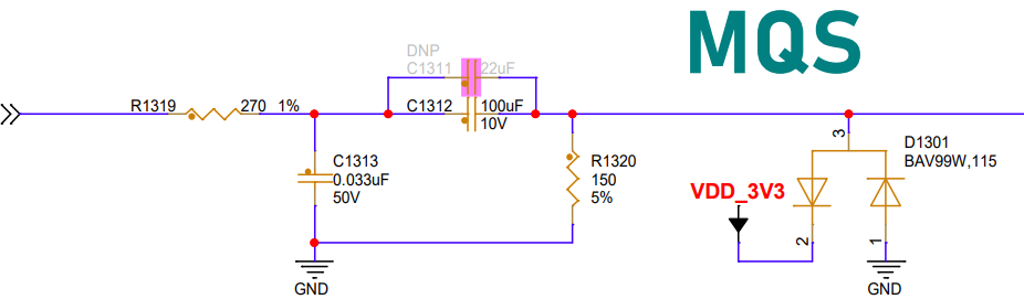

The signal should look like this in the pin output:
And like this after a filter, for example the filter used in i.MX93 EVK.
