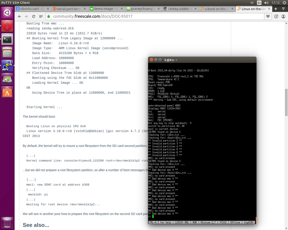

attatch Screenshot.
How to solve this problem?
Best regards!
Dear joowonkim​,
That looks to me like an SD card issue. Try to remove all partitions or blank the card completely, then re-partition and re-flash u-boot and kernel. That might help. Or maybe, try another SD card.
V.

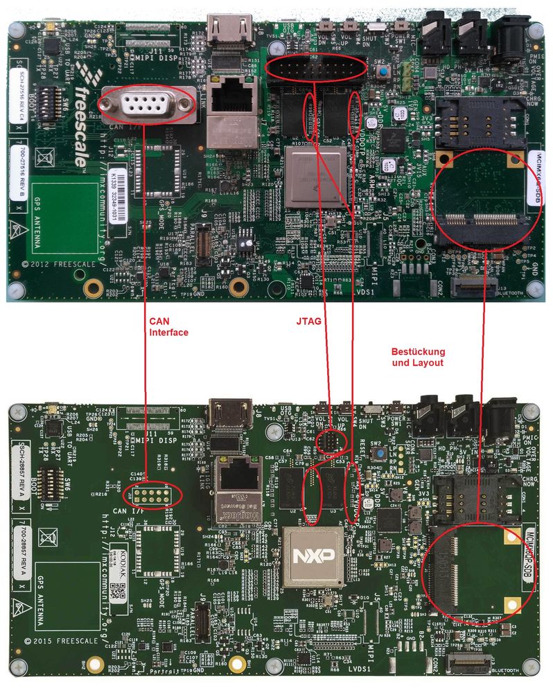

this doesn't seem to work anymore.
I tried to set up U-Boot and Kernel according to this Thread and the "u-boot on the i.MX6 sabre sd platform in a few commands"-Thread.
But this results always in a permanent bootup loop on my Board (2012)
The Devicetree of SabreSD has changed significally since Kernel 4.9.
There seem to exist a newer Version of SabreSD (2015). Is that compatible to newer Kernels? What are the Differences?
See attached Image for some obvious changes on SabreSD. Are there some other not so obvious changes which may lead to described behaviour?
