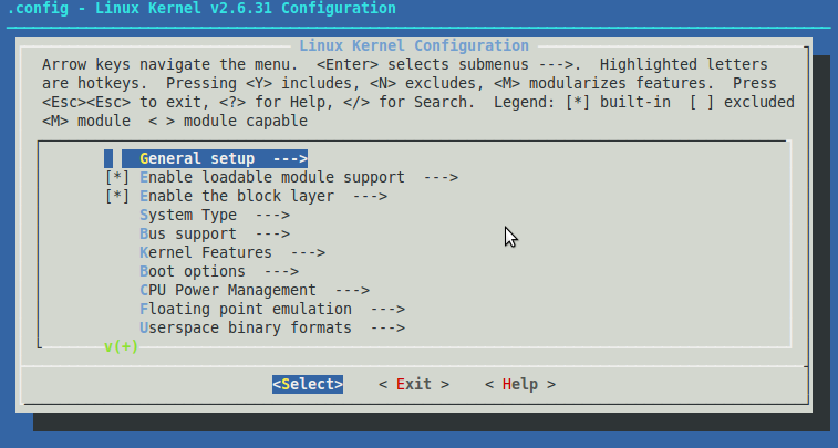

Linux kernel can be easily built using Ltib. On Ltib menu, just select:
[*] Configure the Kernel
When you exit this menu, Ltib will show the Kernel Menuconfig as below:
This is the Kernel Menuconfig, where it's possible to configure kernel options and drivers.
After exit this menu, kernel will be built and stored at:
<Ltib directory>/rootfs/boot
