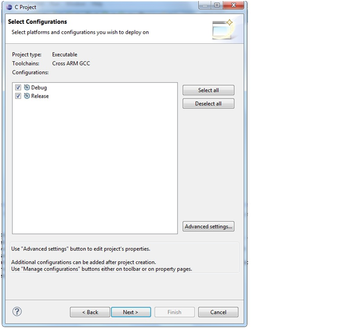

and GNU ARM tools is installed, we should create new “C” project under Eclipse :
New -> C Project. Select “Empty Project” and “Cross ARM GCC”, enter “Project
name”.
Then : select “Advanced settings” -> C/C++ Build -> Settings

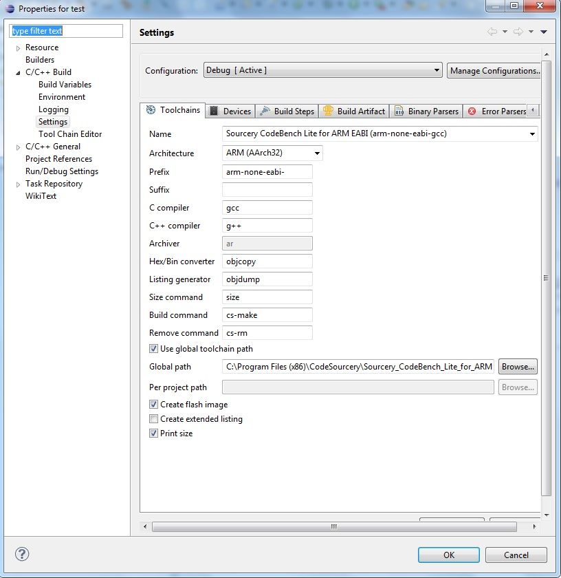

TAB “Toolchains” :
Name : Sourcery CodeBench Lite for ARM EABI (arm-none-eabi-gcc)
(If needed customers can select appropriate toolchain)
Architecture : ARM (AArch32)
Prefix : arm-none-eabi
Check “Use global toolchain path” or select the required path directly.

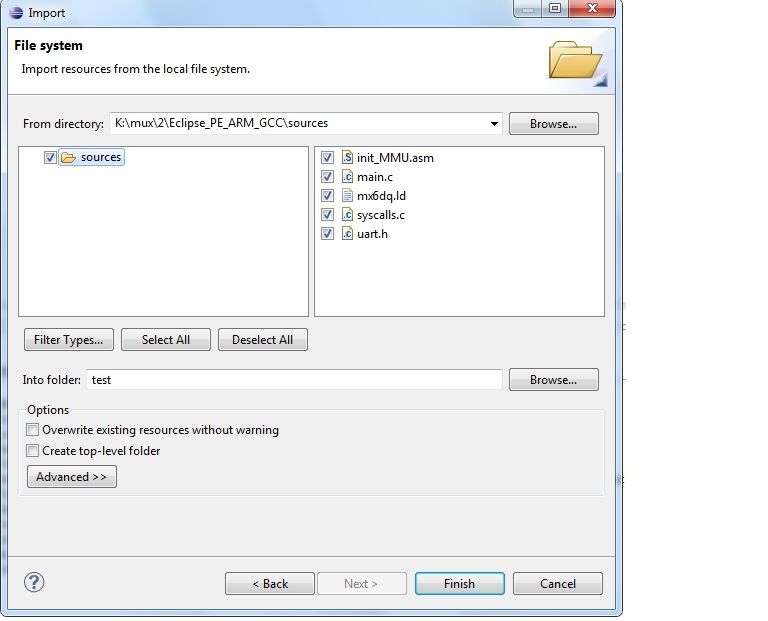

Source codes may added via Eclipse : File -> Import -> File System -> From directory
Example source is enclosed.

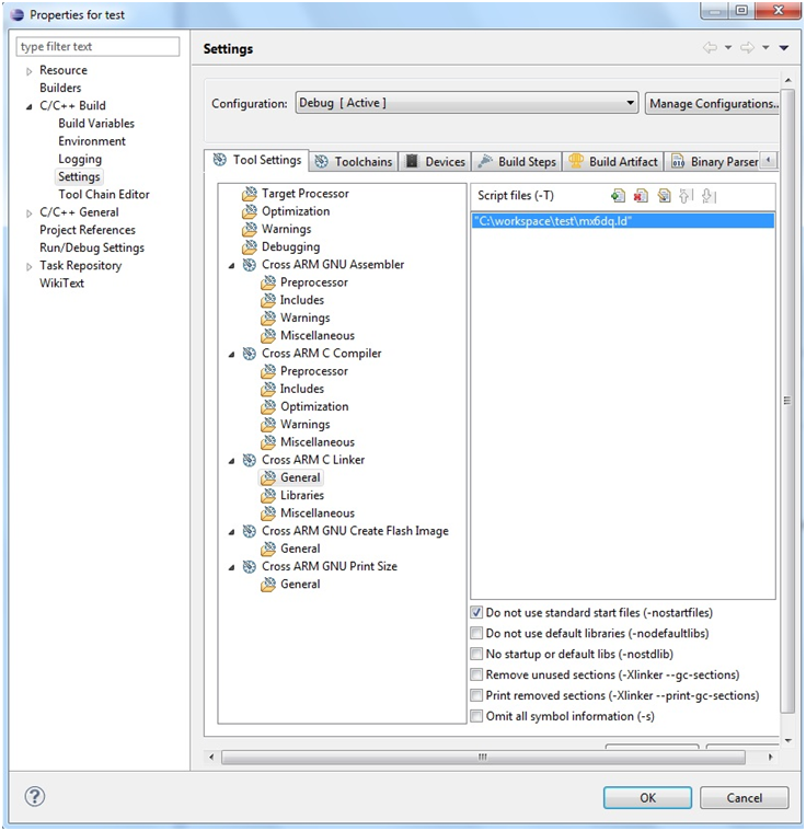

After sources as included in the project, let’s configure linker options via
project properties,
C/C++ Build -> Settings -> Tool Settings -> Cross ARM C Linker -> General.
Add script file “mx6dq.ld”, uncheck “Remove unused section”, check
“Do not use standard start files”.
