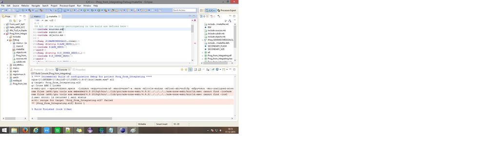

I have built the above program using GCC ARM GCC ARM Embedded in Launchpad . However given sample is compiled using Sourcery CodeBench Lite (which is available for evaluation period of 30 days only).
I get errors when compiled with GCC ARM. Check .jpg attachedlcs3arm_errror.jpg
Building target: Prog_from_Integrating.elf
Invoking: Cross ARM C Linker
arm-none-eabi-gcc --specs=rdimon.specs  -lrdimon -mcpu=cortex-a9 -march=armv7-a -marm -mlittle-endian -mfloat-abi=softfp -mfpu=neon -mno-unaligned-access -O0 -fmessage-length=0 -fsigned-char -ffunction-sections -fdata-sections  -g3 -T "E:\Kepler_Programs\Prog_from_Integrating\mx6dq.ld" -nostartfiles -Wl,-Map,"Prog_from_Integrating.map" -o "Prog_from_Integrating.elf"  ./main.o
c:/program files (x86)/gnu tools arm embedded/4.9 2015q3/bin/../lib/gcc/arm-none-eabi/4.9.3/../../../../arm-none-eabi/bin/ld.exe: cannot find -lcs3arm
collect2.exe: error: ld returned 1 exit status
makefile:41: recipe for target 'Prog_from_Integrating.elf' failed
make: *** [Prog_from_Integrating.elf] Error 1
It shows cs3arm & cs3 cannot find. These are written in mx6dq.ld (linker Script)  at GROUP(-lgcc -lc -lcs3arm -lcs3).

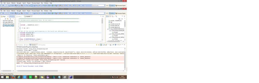

If I remove them from GROUP I get this 'Reset Handler' error.Check .jpg attachedResetHandler_error.jpg
c:/program files (x86)/gnu tools arm embedded/4.9 2015q3/bin/../lib/gcc/arm-none-eabi/4.9.3/../../../../arm-none-eabi/bin/ld.exe: warning: cannot find entry symbol Reset_Handler; defaulting to 00900000
./main.o: In function `start_secondary_cpu':
E:\Kepler_Programs\Prog_from_Integrating\Debug/../main.c:124: undefined reference to `Reset_Handler'
Any help to solve this error would be appreciated? I want to build it using GCC ARM. (not Sourcery CodeBench)

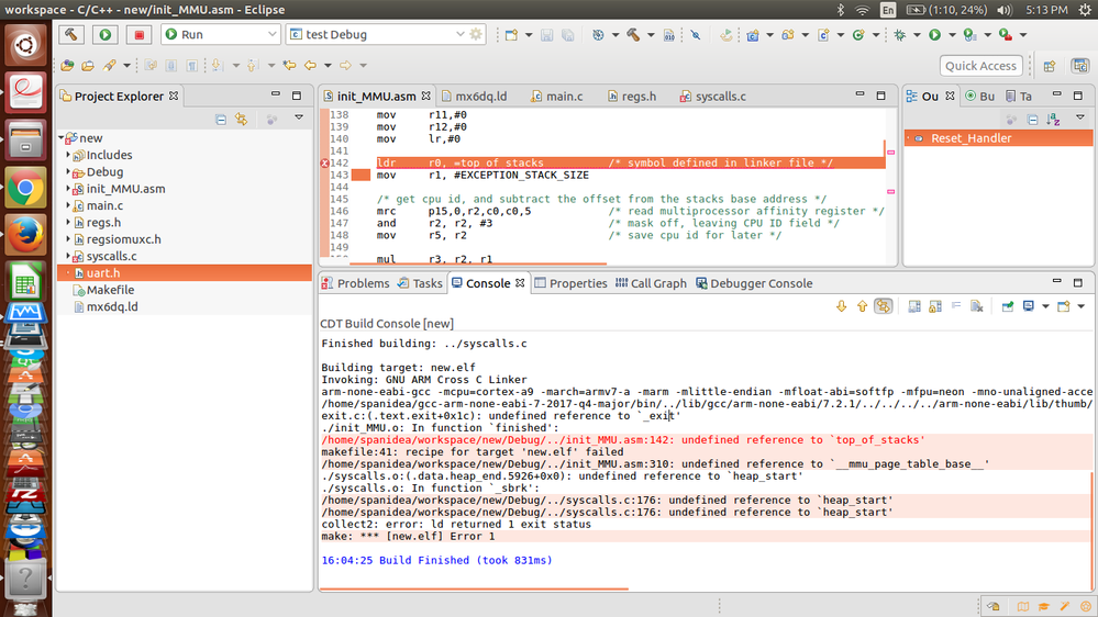

  values of heap_start, top_of_stacks  and __mmu_page_table_base__ are defined in linker file
mx6dq.ld. Verify if it is involved in Your case.
Yuri.

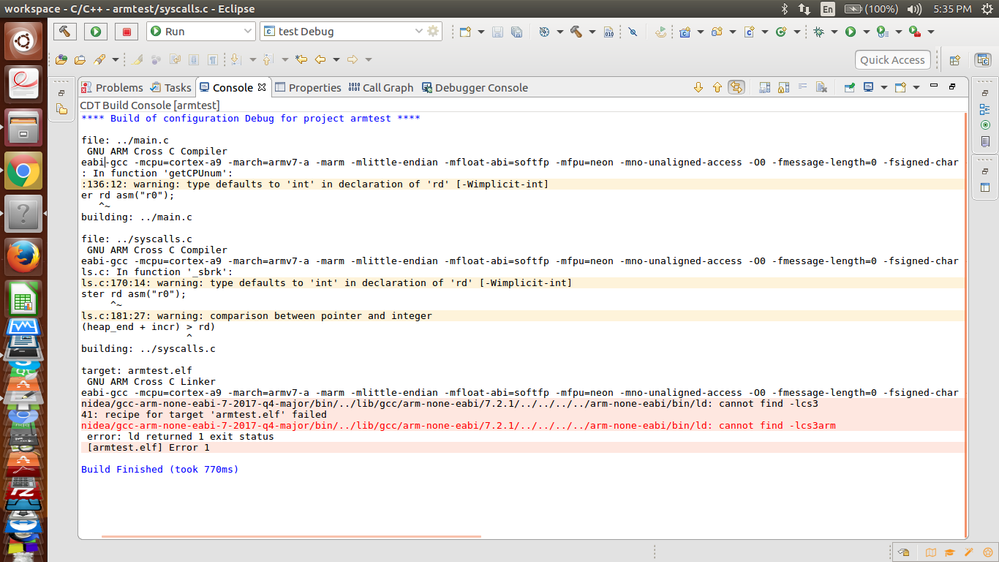

Hi Yuri Muhin,
I am getting error for -lcs3 and -lcs3arm,
are they library?
  the mentioned  lcs3 concerns with Sourcery CodeBench toolchain specifics.
Perhaps for Your toolchain linker file should be modified.
Yuri.
solve library issue:
-lcs3, -lcs3arm library issue.
from here:
-lcs3 and -lcs3arm library
