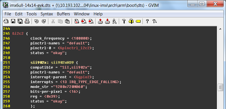

Note: If you want to use the HDMI port instead of LCD to output the screen,
you should modify the file /arch/arm/boot/dts/imx6ull-14x14-evk.dts to add a child node in &i2c2 :
sii902x: sii902x@39 {
        compatible = "SiI,sii902x";
        pinctrl-names = "default";
        interrupt-parent = <&gpio2>;
        interrupts = <13 IRQ_TYPE_EDGE_FALLING>;
        mode_str ="1280x720M@60";
        bits-per-pixel = <16>;
        reg = <0x39>;
        status = "okay";
make imx_v7_defconfig

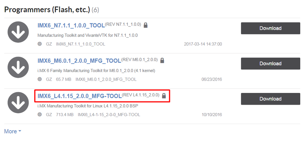

Download the MfgTool in:
http://www.nxp.com/products/automotive-products/microcontrollers-and-processors/arm-mcus-and-mpus/i....
Select the “IMX6_L4.1.15_2.0.0_MFG-TOOL” and download.

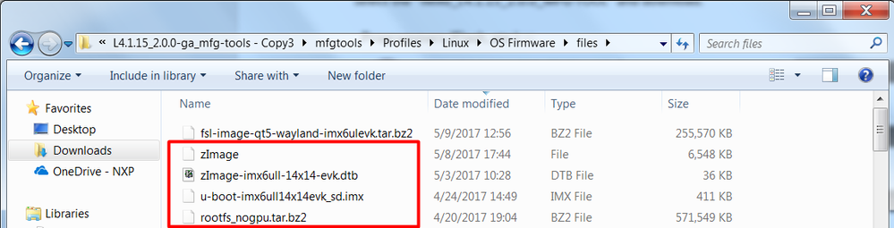

Extract “L4.1.15_2.0.0-ga_mfg-tools.tar.gz” to Windows, and then extract again the “mfgtools-with-rootfs.tar.gz” to <your path>/mfgtools/.
You should rename the files in the folder ~/out/ and copy to the path <your path>/mfgtools/Profiles/Linux/OS Firmware/files/ to replace the original files:
u-boot.imx -> u-boot-imx6ull14x14evk_sd.imx
zImage -> zImage
imx6ull-14x14-evk.dtb -> zImage-imx6ull-14x14-evk.dtb
linaro-jessie-alip-20160428-22.tar.bz2 -> rootfs_nogpu.tar.bz2

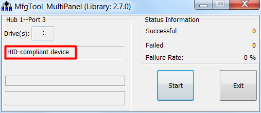

Switch the SW602 in i.MX6ULL EVK board to D1: off, D2: on, insert the TF card in slot SD2 and power on the board.
Connect the board with PC by two micro-USB to USB cables(one is for downloading and another is for watching log)
Finally, open the script “mfgtool2-yocto-mx-evk-sdcard-sd2.vbs” in the <your path>/mfgtools/.3.png
When the “HID-compliant device” shows then click “Start”.
If the processing is done, all things have been download to the board and you can go to the next step.

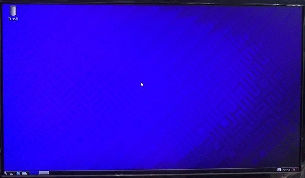

Then power on the board and the logs will show in the serial console. Debian 8 will automatic login to root.

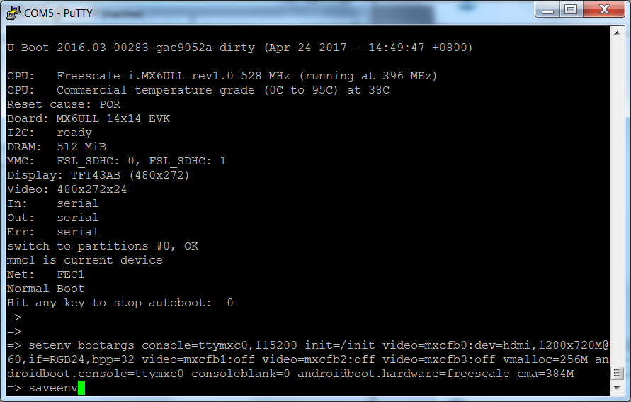

you should press any key when the log: Hit any key to stop autoboot shows and change the bootargs like following example:
setenv bootargs console=ttymxc0,115200 init=/init video=mxcfb0:dev=hdmi,1280x720M@60,if=RGB24,bpp=32 video=mxcfb1:off video=mxcfb2:off video=mxcfb3:off vmalloc=256M androidboot.console=ttymxc0 consoleblank=0 androidboot.hardware=freescale cma=384M
saveenv

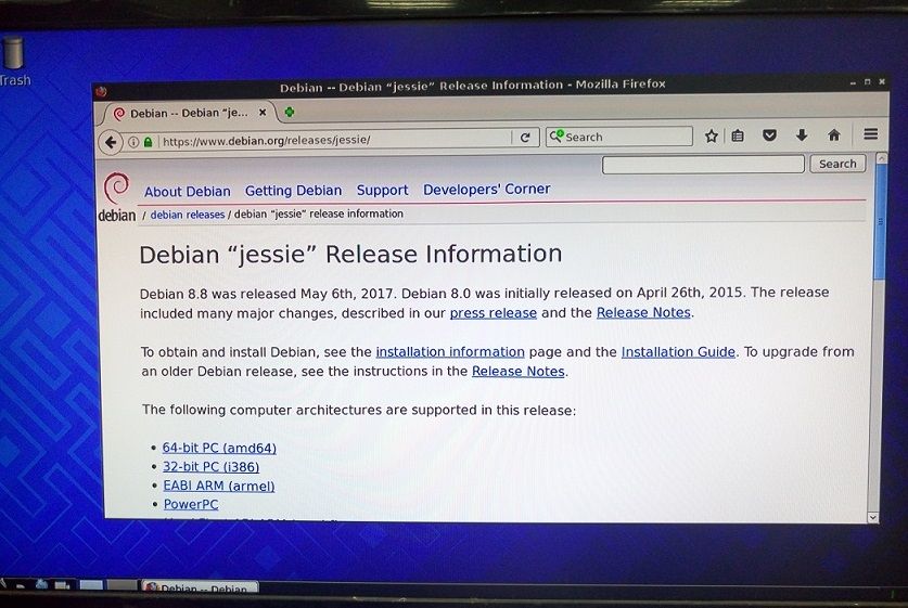

When inputting “startx &” in serial console, the alip GUI will appear in the screen.
You can also use command ”apt-get” to install softwares(E.g. Firefox as following).

How does the GUI perform in this setup? i.MX6ULL does not have a GPU so GPU acceleration must be out of question.
GUI runs fine. GPU acceleration isn't needed for simple 2D menus and pre-rerendered graphics. The memory footprint of X11 and the gnome desktop aren't that big either.
I understand. Thanks for the information.

U-Boot 2016.03 (Mar 24 2019 - 21:36:01 -0400)
CPU: Freescale i.MX6ULL rev1.0 at 396MHz
CPU: Commercial temperature grade (0C to 95C) at 41C
Reset cause: POR
Board: MX6ULL 14x14 EVK
I2C: ready
DRAM: 512 MiB
MMC: FSL_SDHC: 0, FSL_SDHC: 1
*** Warning - bad CRC, using default environment
Display: TFT43AB (480x272)
Video: 480x272x24
In: serial
Out: serial
Err: serial
switch to partitions #0, OK
mmc1 is current device
Net: FEC1
Normal Boot
Hit any key to stop autoboot: 3     2     1     0
reading boot.scr
** Unable to read file boot.scr **
reading zImage
6705288 bytes read in 303 ms (21.1 MiB/s)
Booting from mmc ...
reading imx6ull-14x14-evk.dtb
35969 bytes read in 21 ms (1.6 MiB/s)
Kernel image @ 0x80800000 [ 0x000000 - 0x665088 ]
## Flattened Device Tree blob at 83000000
Booting using the fdt blob at 0x83000000
Using Device Tree in place at 83000000, end 8300bc80
Starting kernel ...

hi david,
here is the complete log from boot.  what's your host env when you build debian for imx6ull-evk. actually i downloaded the tar files and do exactly to the above instructions. there is no error during compile. but kernel crash during run.
Reset cause: POR
I2C: ready
DRAM: 512 MiB
Video: 480x272x24
In: serial
Out: serial
Err: serial
Net: FEC1
Normal Boot
reading boot.scr
reading zImage
Starting kernel ...
Booting Linux on physical CPU 0x0
Linux version 4.1.15 (weji@weji-VirtualBox) (gcc version 6.3.1 20170109 (Linaro GCC 6.3-2017.02) ) #1 SMP PREEMPT Sun Mar 24 22:01:56 EDT 2019
CPU: ARMv7 Processor [410fc075] revision 5 (ARMv7), cr=10c53c7d
CPU: PIPT / VIPT nonaliasing data cache, VIPT aliasing instruction cache
Machine model: Freescale i.MX6 ULL 14x14 EVK Board
Reserved memory: created CMA memory pool at 0x8c000000, size 320 MiB
Reserved memory: initialized node linux,cma, compatible id shared-dma-pool
Memory policy: Data cache writealloc
PERCPU: Embedded 12 pages/cpu @8bb32000 s16908 r8192 d24052 u49152
Built 1 zonelists in Zone order, mobility grouping on. Total pages: 130048
Kernel command line: console=ttymxc0,115200 root=/dev/mmcblk1p2 rootwait rw
