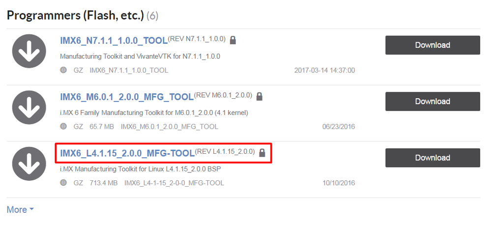

Download the MfgTool in:
http://www.nxp.com/products/automotive-products/microcontrollers-and-processors/arm-mcus-and-mpus/i....
Select the “IMX6_L4.1.15_2.0.0_MFG-TOOL” and download.

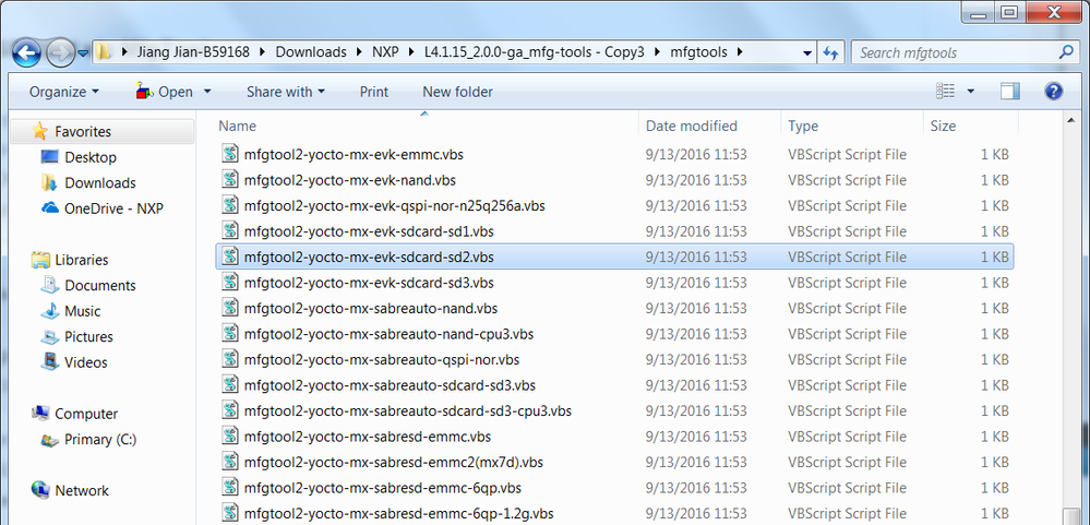

Extract “L4.1.15_2.0.0-ga_mfg-tools.tar.gz” to Windows, and then extract again the “mfgtools-with-rootfs.tar.gz” to <your path>/mfgtools/.
You should rename the files in the folder ~/out/ and copy to the path <your path>/mfgtools/Profiles/Linux/OS Firmware/files/ to replace the original files:
u-boot.imx -> u-boot-imx6ull14x14evk_sd.imx
zImage -> zImage
imx6ull-14x14-evk.dtb -> zImage-imx6ull-14x14-evk.dtb
linaro-jessie-alip-20160428-22.tar.bz2 -> rootfs_nogpu.tar.bz2
Switch the SW602 in i.MX6ULL EVK board to D1: off, D2: on, insert the TF card in slot SD2 and power on the board.
Connect the board with PC by two micro-USB to USB cables(one is for downloading and another is for watching log)

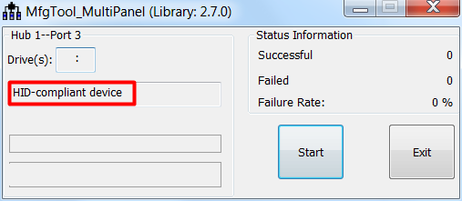

Finally, open the script “mfgtool2-yocto-mx-evk-sdcard-sd2.vbs” in the <your path>/mfgtools/.3.png
When the “HID-compliant device” shows then click “Start”.
If the processing is done, all things have been download to the board and you can go to the next step.

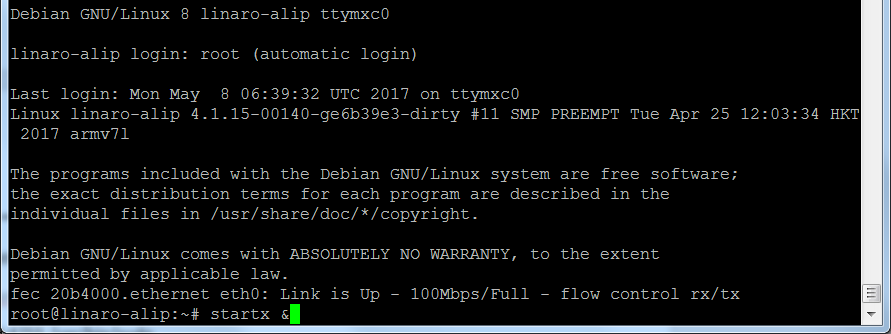

Then power on the board and the logs will show in the serial console. Debian 8 will automatic login to root.
Note: If you want to use the HDMI port instead of LCD to output the screen,
you should press any key when the log: Hit any key to stop autoboot shows and change the bootargs like following example:
setenv bootargs console=ttymxc0,115200 init=/init video=mxcfb0:dev=hdmi,1280x720M@60,if=RGB24,bpp=32 video=mxcfb1:off video=mxcfb2:off video=mxcfb3:off vmalloc=256M androidboot.console=ttymxc0 consoleblank=0 androidboot.hardware=freescale cma=384M
saveenv

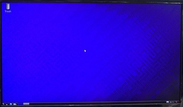

When inputting “startx &” in serial console, the alip GUI will appear in the screen.

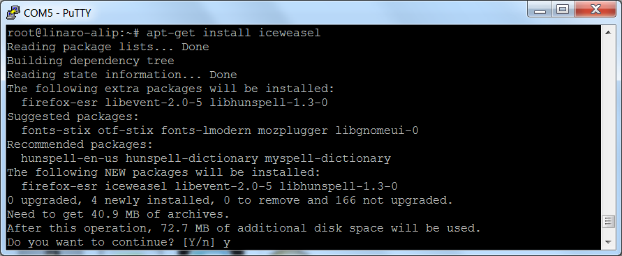

You can also use command ”apt-get” to install softwares(E.g. Firefox as following).

after  i use mfgtool2-yocto-mx-evk-sdcard-sd2.vbs to download prebuild application, which is in L4.1.15_2.0.0-ga_mfg-tools.tar.gz. it works very well.

You can use the default uboot, zImage and dtb file in MFGTool and jessie rootfs your build for a trial.
