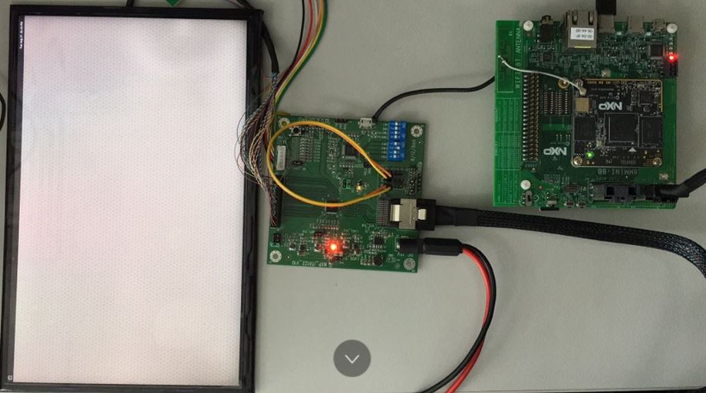

1. HW Environment:
    IMX8mm-evk board.
    ITE6122 mipi dsi to lvds bridge board.
    B101UAN02.1 1920x1200 LVDS panel
2. SW Environment:
    IMX YOCTO 4.14.98-2.0.0ga release.
3. Patch operation:
    a. git clone https://source.codeaurora.org/external/imx/linux-imx.git
    b. git checkout -b  imx_4.14.98_2.0.0_ga remotes/origin/imx_4.14.98_2.0.0_ga
    c. patch -p1 < ../ite6122_imx8mm_4.14.98ga_18c3fd8837fc3c6_0512.patch
4. Tested on imx8mm-evk board:
5. Attached doc list:
     i.MX8MM(MN)_IT6122FN_ user guide_V0.20.pdf ------  ite6122 bridge board HW guide
     i.MX8MM(MN)_IT6122FN_V11_20200513.pdf  ------  ite6122 bridge board SCH
     ite6122_imx8mm_4.14.98ga_18c3fd8837fc3c6_0512.patch  ------  Linux kernel driver patch
     B101UAN02.1_Ver1.0.pdf -------  panel spec
     2020/10/30: 6122-hw-version-2010-10-30.zip ------ updated new HW design.
