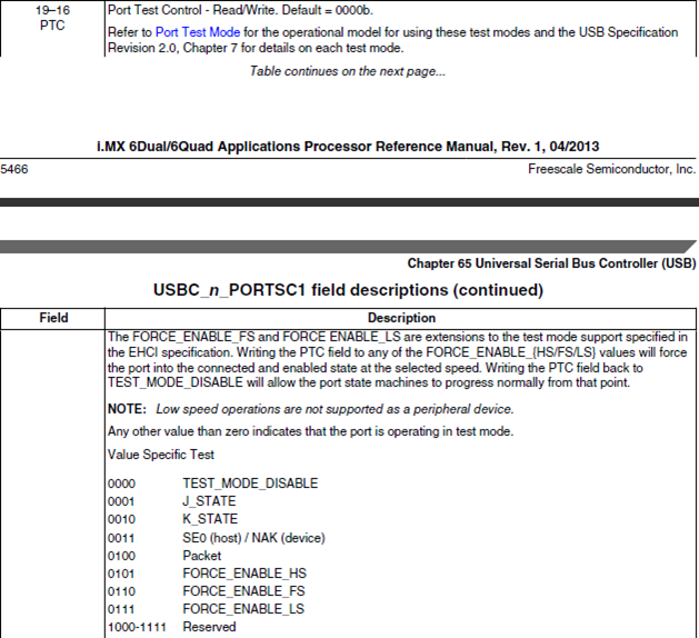

3. Description of USBCertification related Registers
AN4589 Configuring USB on i.MX 6 Series Processors
http://cache.freescale.com/files/32bit/doc/app_note/AN4589.pdf
