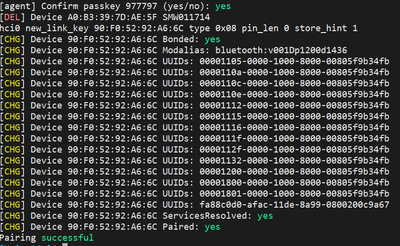

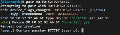

         [bluetooth]# pair 90:F0:52:92:A6:6C
         we need to type Yes on board and click 配对 on phone.

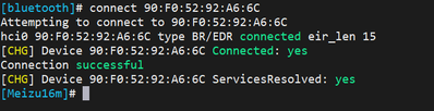

        [bluetooth]# connect 90:F0:52:92:A6:6C
        [Meizu16m]# quit

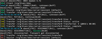

         root@imx8mp-lpddr4-evk:~# /usr/libexec/bluetooth/obexd -a -n -r /root/ & obexctl
         Then select a file on your phone ad choose transfer by Bluetooth.

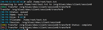

        2).i.MX8MP EVK Board -> Android Phone
         [obex]# connect 90:F0:52:92:A6:6C
         [90:F0:52:92:A6:6C]# send /home/root/test.txt
