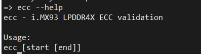

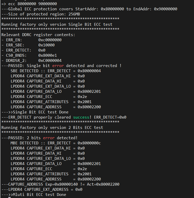

ECC test step:
1. Flash the attachment file to the imx93 board.
2. Enter the uboot, run the "ecc --help" command, you will see the below help output message
3. For example : ecc 0x80000000 0x90000000, it will test the ecc feature with on bit error detect and correct , 2 bits errors detect with 256MB DRM size.
if you need this ECC_ test binary file, please contact me, i will share it to you
