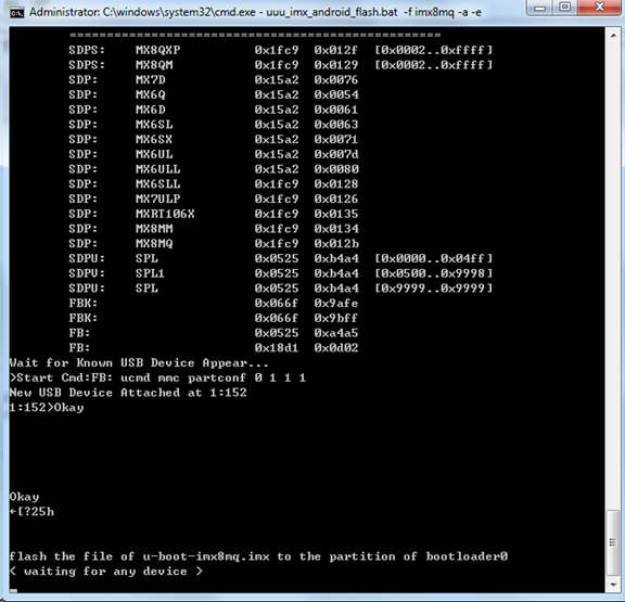

  1. running “uuu_imx_android_flash.bat -f imx8mq -a -e
Below lines will be showed on windows console:
flash the file of u-boot-imx8mq.imx to the partition of bootloader0
<waiting for any devices>
            Then downloading operation stopped.

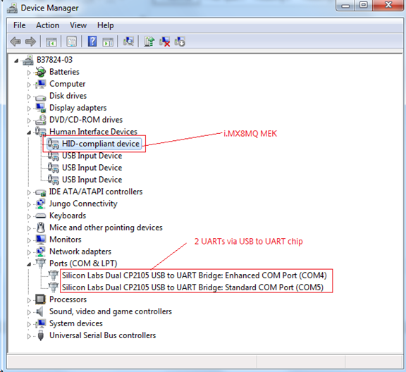

(1) Related windows drivers for i.MX8MQ MEK
                Windows 7 64bit or windows 10 64bit will find new devices and begin to search and install corresponding drivers, like below:
                Probably windows 10 64bit can’t automatically install CP2105 driver from official website of manufacture:
https://www.silabs.com/products/development-tools/software/usb-to-uart-bridge-vcp-drivers
                Then installed it manually.

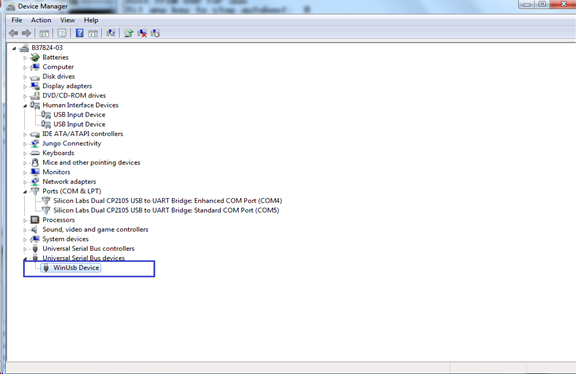

(2) Power off i.MX8MQ MEK

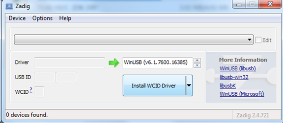

(3) Installing winusb driver by zadig
                According to method described in uuu.pdf, download zadig tool from https://zadig.akeo.ie/, and install it to windows 7 64bit .
[Note] windows 10 64bit doesn’t need to install winusb driver.
Press “Install WCID Driver” Button

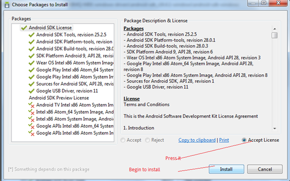

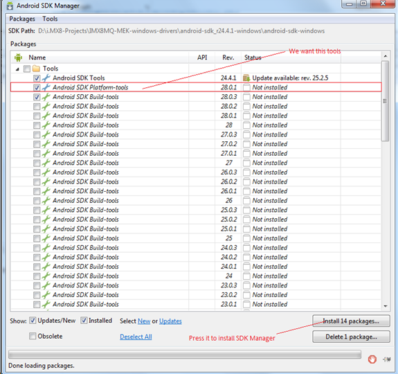

(4) Downloading Android SDK Manager
Download SDK Manager from :
http://visualgdb.com/android/install_redir?item=SDK
After downloading it, decompress it, and run SDK Manager application:
Press OK.
Then press “Close”
Close SDK Manager Installation Guide .

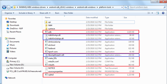

Find the directory of SDK Manager installation, and enter into “platform-tools”, like below:
D:\i.MX8-Projects\IMX8MQ-MEK-windows-drivers\android-sdk_r24.4.1-windows\android-sdk-windows\platform-tools
Copy items in blue rectangle to C:\windows\system
Copy items in red rectangle to C:\windows\system32

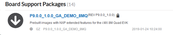

(1) Downloading android DEMO images for i.MX8MQ MEK
https://www.nxp.com/support/developer-resources/software-development-tools/i.mx-developer-resources/...
After downloading it, decompress it to a directory.  Like below:

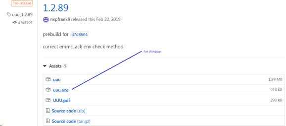

(2) Downloading UUU Tool
https://github.com/NXPmicro/mfgtools/releases
After downloading uuu.exe,  copy it to the directory of android 9.0 demo image , see above.

---run “uuu_imx_android_flash.bat -f imx8mq -a -e
          For windows 10 64bit, downloading images will be done without any errors.

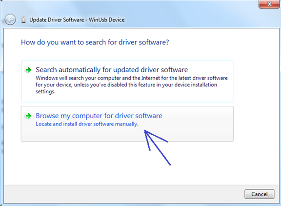

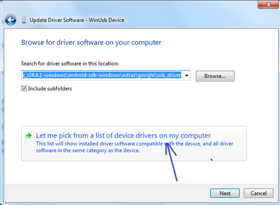

   But for windows 7 64bit, downloading images will stop at “ waiting for any devices”.

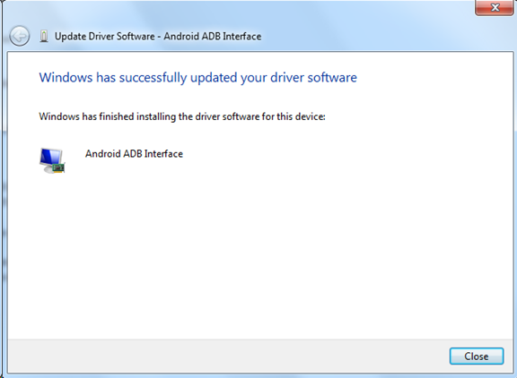

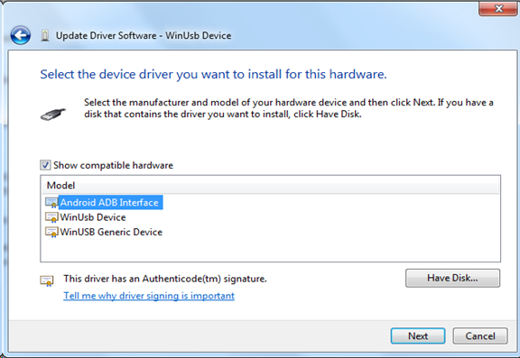

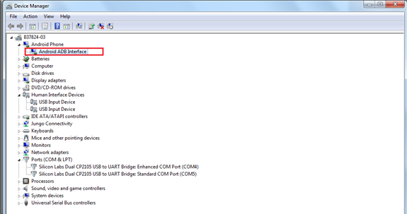

   It means Android ADB driver will be needed. Follow the steps below to solve the problem.
Right button, click “update driver”
Close it.
          Then downloading operations will be automatically continued.
OK, done.
