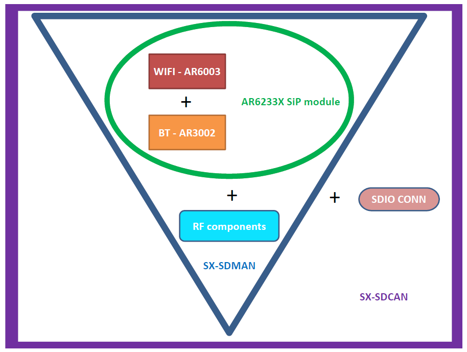

Here is the explaination of relationship of SD-CAN, SD-MAN, 6233, 6003, 3002:
  • AR6003 + AR3002 = AR6233
  • AR6233 + RF Components = SX-SDMAN-2830S
  • SX-SDMAN-2830S + SDIO CONN = SX-SDCAN-2830BT
  • SX-SDCAN-2830BT card is inserted into SD3 slot.
  • BT adaptor board (attached files) is inserted into SD1 slot.
  • SX-SDCAN-2830BT card is connected with BT adaptor board via 20-pin FFC.

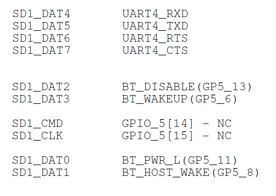

  • Software: signals of SD1 are muxed into UART4 and GPIO for BT application.
Below is the description of IO mux on SD1:

del , Hello -
Taking the below link into account , do we need such hardware changes to do in the SoloLite EVK , ?
How to enable BT on board imx6q_sabresd RevC.
Let me know your views on this.
--Pankaj Rana
del
Hi pankajrana,
No HW rework is need on SL EVK board.
You just need the additional "BT adaptor board" and proper S/W.
