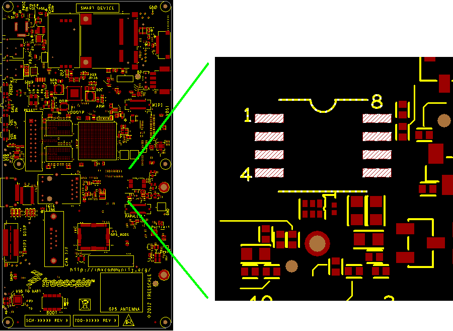

The purpose of this document is to describe how to enable Bluetooth on i.MX 6Dual/Quad SabreSD board (RevC) for Android software.
i.MX 6Dual/Quad SabreSD board doesn't enable Bluetooth connection by default. To support bluetooth, the hardware rework is required.
The above diagram shows the reserved connections for Bluetooth in SabreSD RevC board (All connections are marked as "DNP"). This Bluetooth cable connector is designed specifically for the WiFi/BT combo card SX-SDCAN-2830BT which is developed and sold by Silex Technology. Note that pin 1 (BT_DISABLE) of the cable connector on i.MX 6Dual/Quad SabreSD RevC is opposite Pin 20 of the WiFi/BT module. Note: when connecting Silex module and J13, the connection is reverted (For example, PIN 1 in J13 connects to PIN 20 in Silex module). To use the J13 connector, the following reworks are required:

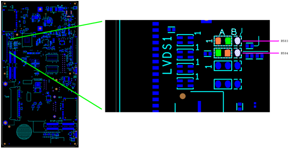

Where is them, you can refer to the below chart.
Orange PAD connects to Orange PAD.
Green PAD connects to Green PAD.
After hardware rework, the Bluetooth connection will like the following:
