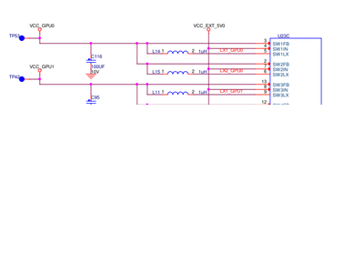

Validation Test
Apply patch into Linux kernel, SCFW porting kit, ATF, follow 6.6.52_2.2.0 release document(www.nxp.com/design/design-center/software/embedded-software/i-mx-software/embedded-linux-for-i-mx-ap...) to build and deploy image.
After Linux OS boot up,  run below command to check A72 and GPU frequency,  for example:
#cat /sys/kernel/debug/gc/clk
gpu0 mc clock: 647981058 HZ.
gpu0 sh clock: 695997687 HZ.
gpu1 mc clock: 647990370 HZ.
gpu1 sh clock: 695987994 HZ
#cat /sys/devices/system/cpu/cpu4/cpufreq/cpuinfo_max_freq
1296000
Measure VDD_GPU voltage from i.MX8QM MEK board TP53 and TP42
