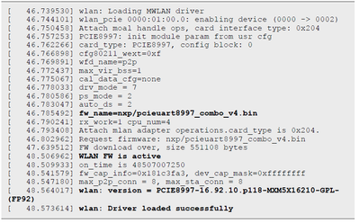

Load the modules in the kernel:
Verify the kernel debug messages in the command output

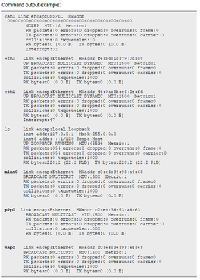

Verify that the module is now visible to the system:

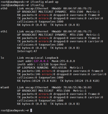

  1. Now that the module is ready to work, we need to enable it, in my case the Wi-Fi is named mlan0, it could vary on other Linux systems.

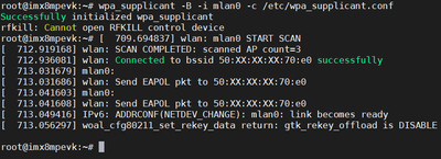

  1. Identify your network and add it to the  WPA supplicant file:
  1. Associate the Wi-Fi with config:

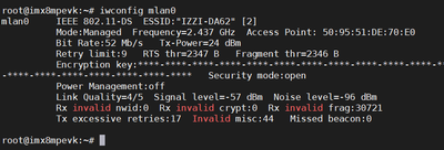

  1. Check if you have right SSID associated:

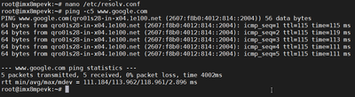

  1. Ping any public site you know to check the network.nxf63675_12-1637803048071.png
  2. In the case you have a Temporary failure in name resolution you will need to change the default DNS that was assigned by DHCP:
Modify /etc/resolv.conf file and add the DNS of your preference, for my case I add the one that uses Google, as they have access to the most common web pages.
And with that should work.
