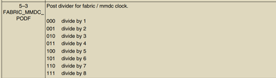

3. CBCDR[FABRIC_MMDC_PODF] : It is a frequency divider. The frequency division value is set by the FABRIC_MMDC_PODF bit (bit5:3) of the CBCDR register. It can be set to 0~7, corresponding to 1~8 frequency divisions respectively. To configure the clock source of the MMDC to 396MHz, it must be set to 1 here, so FABRIC_MMDC_PODF=0.

As default BSP code, our DDR run frequency is 400MHz (Actually, it's 396MHz), If you want DDR to boot at 132MHz, we need to configurate the CCM_CBCDR[FABRIC_MMDC_PODF] bit,  from this bit content, we need to set it to 010. The frequency division value is 3 based on 396MHz
Change code as following: DATA 4 0x020c4014 0x00018910, Add this code in imximage.cfg file.
