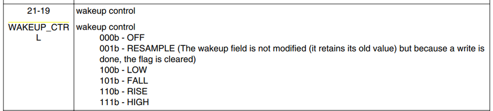

  • The second parameter corresponds to the "'type'", you can find it in the i.MX 8QuadMax Applications Processor Reference Manual, in the page 802:
    For this example we are using "LOW".

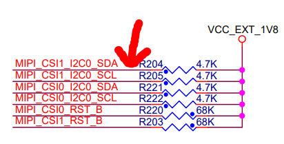

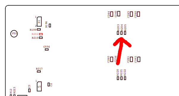

In this example a wire was soldered on "R204":
Run the following command on the MEK CPU Board:
echo mem > /sys/power/state
And you will see something like:
[   53.769266] PM: suspend entry (deep)
[   53.902130] Filesystems sync: 0.129 seconds
[   53.908068] Freezing user space processes ... (elapsed 0.002 seconds) done.
[   53.917189] OOM killer disabled.
[   53.920420] Freezing remaining freezable tasks ... (elapsed 0.001 seconds) done.
[   53.929626] printk: Suspending console(s) (use no_console_suspend to debug)
Connect the wire that was soldered on "R204" to ground, the MEK CPU Board will wake up and you will see something like:
