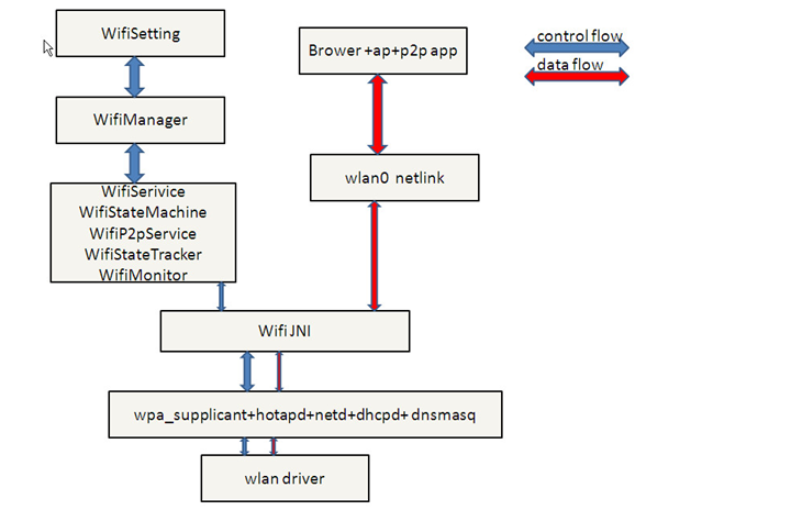

As the following figure, Android wireless architecture can be divided into three parts:
Java Framework(WifiManager, WifiMonitor etc..),
HAL(wifi.c,wpa_supplicant,netd)
kernel space modules(wireless stack, wifi drivers)
Java Framework communicate with wpa_supplicant using native interface (wifi.c). Wpa_supplicant and netd uses wireless extension or nl80211 to control WiFi drivers.
