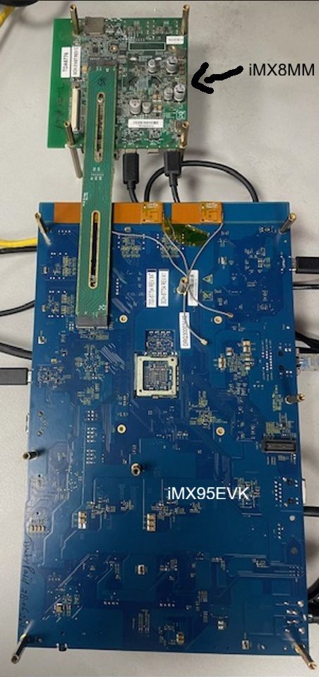

As evident in Figure 1, the system comprises of iMX8MM EVK and iMX95 19x19 EVK connected back-to-back via a M.2 Key E PCIe bridge.
iMX8MM EVK will be the PCIe Endpoint, while iMX95 EVK will act as a PCIe root complex.
iMX95 <------> iMX8MM
[RC]                     [EP]
To set it up in the above configuration, please follow this blog -
Enabling PCIe End-point framework on iMX95 torradex board and iMX8MM EVK - NXP Community
After this, you would successfully be able to trigger pcie transactions between iMX8MM and iMX95 EVKs using the pci endpoint test framework.
With this setup, we will demonstrate how a PCIe EP[iMX8MM EVK] sends legacy INTx interrupt to the PCIe RC[iMX95 EVK]. We will also trace the origin of these interrupts in the linux driver on linux-imx source code.

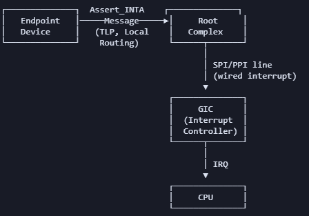

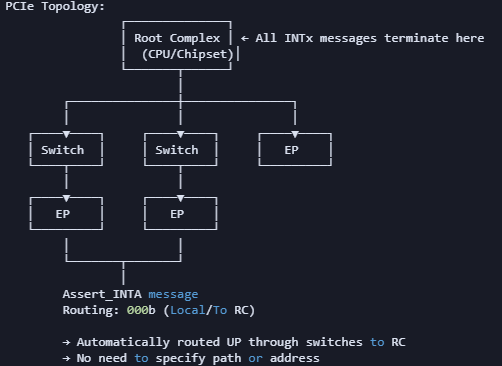

How are INTx legacy interrupts realized in PCIe?
PCI Express supports PCI Interrupts as defined in the PCI Local Bus Specification. It includes the Interrupt Pin and Interrupt Line registers of PCI Configuration Space. PCIe devices support these registers for backward compatibility. So the actual interrupt signaling uses an in-band messages rather than using physical pins.
In PCIe two types of messages are defined as per the specification:-
Assert_INTx and Deassert_INTx for emulating PCI INTx signaling
x -> A/B/C/D
these messages act as "virtual wires" for signaling interrupts across a link. These "virtual wires" in form of messages reach 'Root Complex' which then gets mapped  to the system interrupt controller. This means that when RC receives these in-band "virtual wire" messages, it translates it into appropriate hardware interrupt going to a CPU.
Note:- Mapping of PCI Express INTx emulation to system interrupts is purely implementation specific.  Similar to physical interrupt signals, the INTx emulation mechanism may potentially cause spurious interrupts which must be handled by the system software.

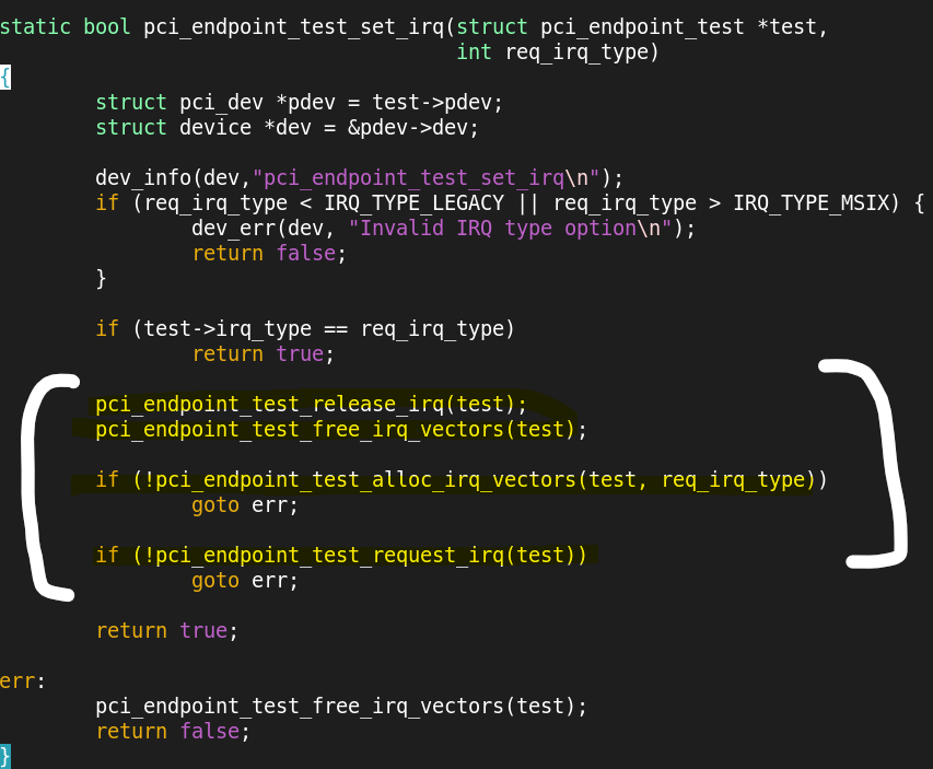

'pcitest -i 0' configures the RC to handle Legacy INTx interrupts. As a result of this, an ioctl call will be made 'PCITEST_SET_IRQTYPE':-
Handled as follows in drivers/misc/pci_endpoint_test.c
Figure. 2Figure. 2
arg is 0 for IRQ_TYPE_LEGACY
Have a look at the below snippet which shows where it all starts: -
Figure. 3Figure. 3
Inside pci_endpoint_test_release_irq
 Figure. 4Figure. 4
test->num_irqs=16 in our case, because on end-point :-
echo 16 > functions/pci_epf_test/func1/msi_interrupts
pci_irq_vector returns the linux IRQ number corresponding to the MSI Interrupt 0 to 16
Then, it frees those irqs using devm_free_irq so that they can be allocated again.

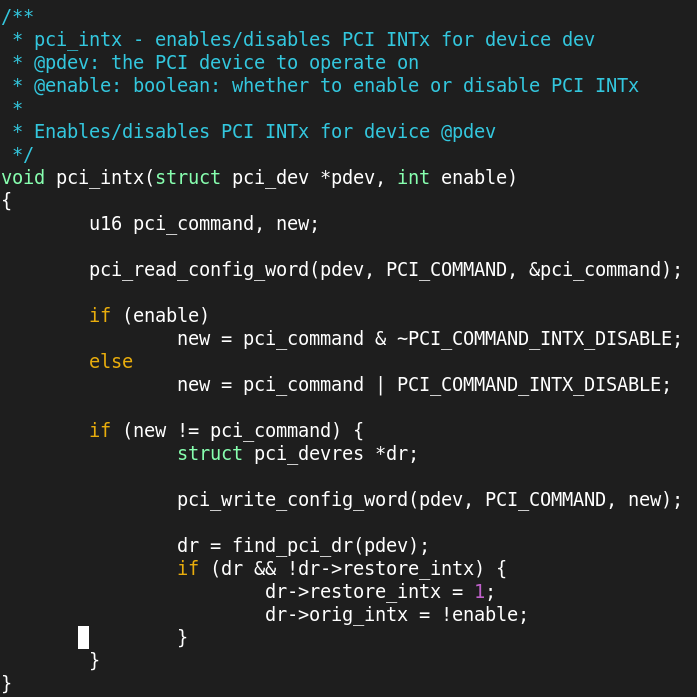

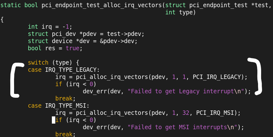

Then, inside pci_endpoint_test_alloc_irq_vectors
Figure. 5Figure. 5

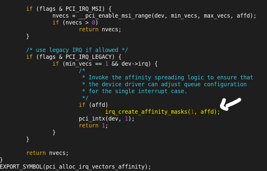

pci_alloc_irq_vectors allocates interrupt vectors for legacy intx interrupts. Deep inside, this creates a cpu affinity mask for cpu core 0 and then pci_intx is called to enable the legacy interrupt by reading and writing to pcie config space:-
 Figure. 6Figure. 6

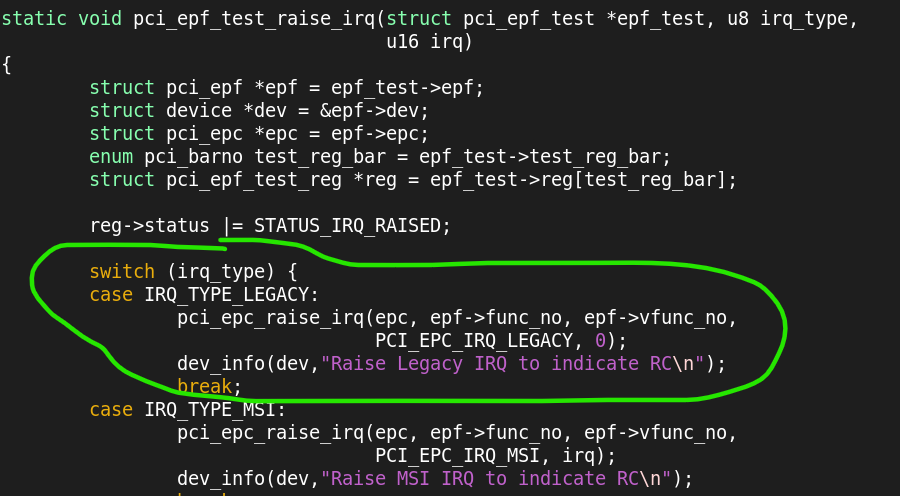

'pcitest -l'
triggers the legacy IRQ test which returns OKAY if everything goes fine. If not, it returns NOT OKAY

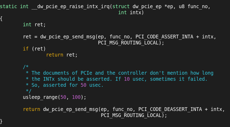

When you execute the above, PCIe RC sends a command 'COMMAND_RAISE_LEGACY_IRQ' to iMX8MM EP on the pcie link. EP on getting this command as part of its handler 'pci_epf_test_cmd_handler' calls 'pci_epf_test_raise_irq'
 Figure. 8Figure. 8
Figure. 9Figure. 9
pci_epc_raise_irq,
ultimately calls __dw_pcie_ep_raise_intx_irq of the patch.
Figure. 10Figure. 10
This sends PCI_CODE_ASSERT_INTA message followed by a delay and then PCI_CODE_DEASSERT_INTA. Both these messages are of routing type PCI_MSG_ROUTING_LOCAL, meaning that the message is routed to a specific function within the same device or to a switch. Unlike memory transactions that need a target address, INTx messages do not have a destination address.
In easy words, it says that "Route this to my local Root complex".
Figure. 11Figure. 11

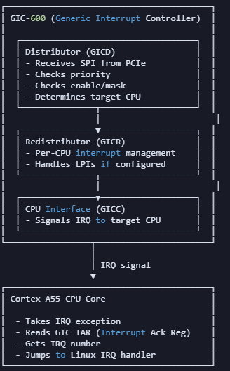

It then reaches the Root Complex iMX95. From there it reaches the interrupt controller [GICv3] using Shared Peripheral Wired Interrupt. The GIC informs one of the cpu cores to handle the interrupt. In our case CPU 0 will be handling it since we have set its affinity to CPU 0. At last pci_endpoint_test_irqhandler will be called in the RC's endpoint test framework.
Figure. 12Figure. 12
Following is the sequence once the interrupt reaches GIC
Figure. 13Figure. 13

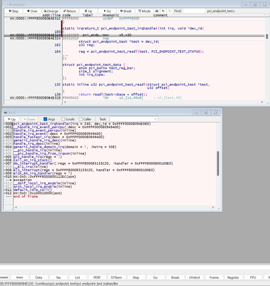

If you connect a JTAG to the iMX95EVK board, you can actually trace the calls when legacy INTx IRQs are handled in linux:-
 Figure. 14Figure. 14

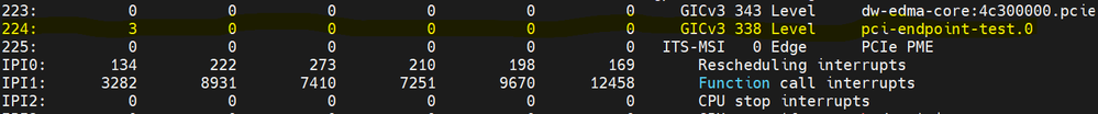

The interrupts routed to the GIC on imx95 can be observed by executing
'cat /proc/interrupts'
every time you trigger a legacy interrupt test using 'pcitest -l'
you will see the following in the output of 'cat /proc/interrupts' in case of INTA
 Figure. 15Figure. 15
The number 3 against CPU0[which handled the interrupt], you will see this will increment every time you trigger a legacy interrupt test. It denotes how many interrupts were generated for the IRQ number on CPU core
Level - type of interrupt
224 is the Interrupt request number

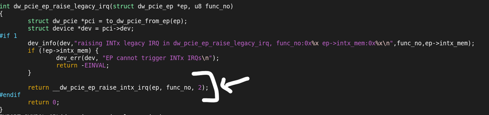

To use INTB, INTC or INTD
  1. In drivers/pci/controller/dwc/pcie-designware-ep.c
     Figure. 16Figure. 16
The 3rd argument of the fn __dw_pcie_ep_raise_intx_irq
0 = INTA
1 = INTB
2 = INTC
3 = INTD
Modify it according to above mapping

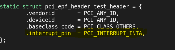

  1. In drivers/pci/endpoint/functions/pci-epf-test.c
     Figure. 17Figure. 17
You can change the interrupt_pin member of the test_header
PCI_INTERRUPT_INTA = INTA
PCI_INTERRUPT_INTB = INTB
PCI_INTERRUPT_INTC = INTC
PCI_INTERRUPT_INTD = INTD

From the above snippets, you must have observed that only core 0 is handling the INTx IRQ. This is because the cpu affinity mask is set to 1 which means cpu core 0.
in kernel/irq/affinity.c
 Figure. 22Figure. 22
The iRQ mask for legacy interrupts is set to 1 - meaning core 0
