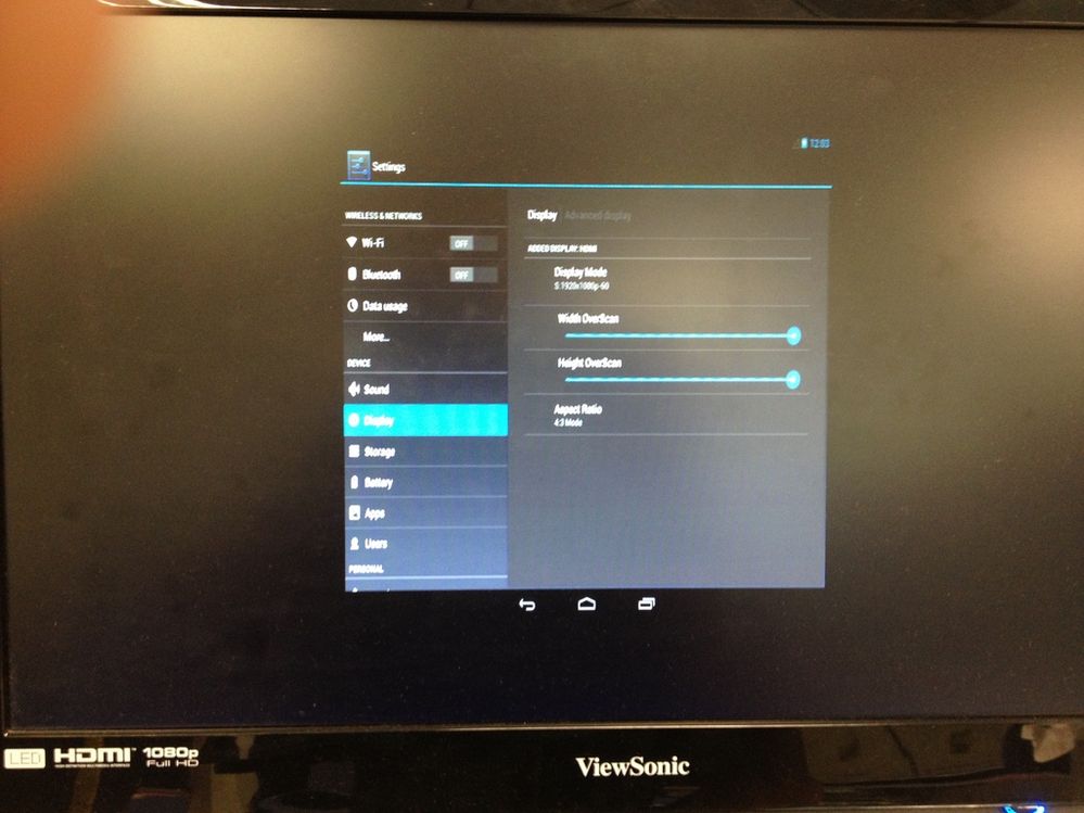

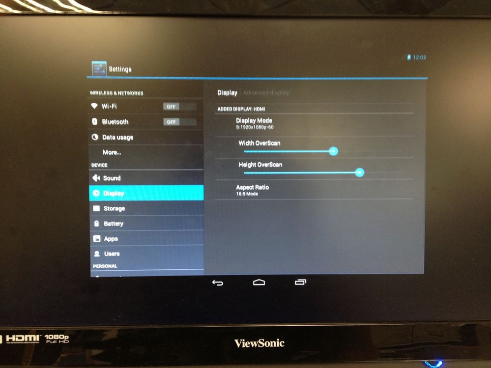

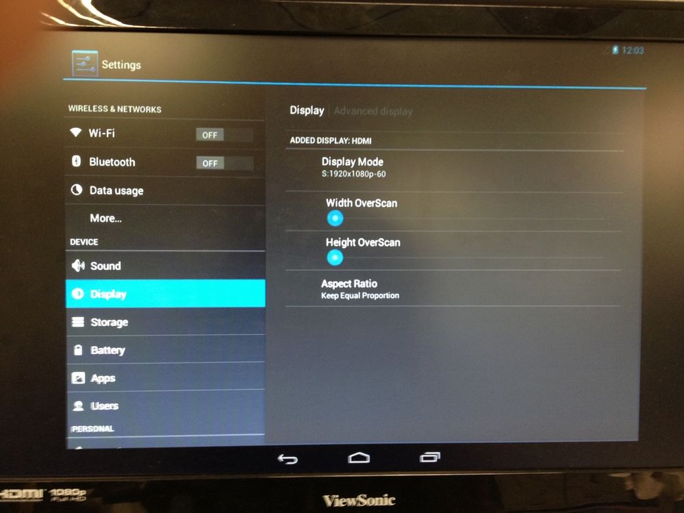

hi, i just tried with clean user and eng build, and that works, as the photos below.

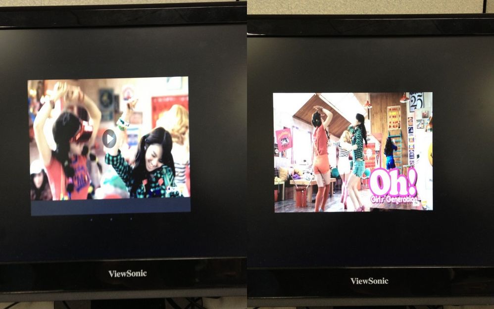

hi i test and the video playback works on hdmi with expected ratio.
