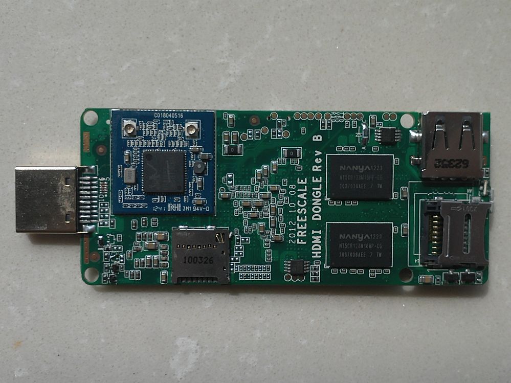

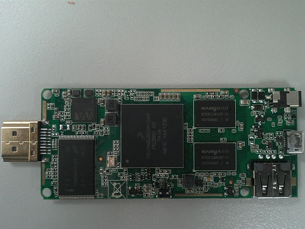

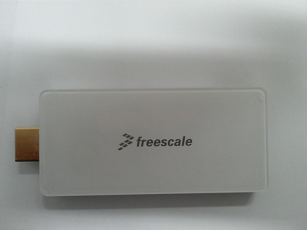

HDMI Dongle HW:
HDMI Dongle schematic, pcb, gerber and BOM have been attached, the detailed hardware feature has been list below:
Android 4.x HDMI Dongle SPECIFICATION
Core Configure
Operating SystemAndroid 4.x Operating System Based on Micro-PC Platform
CPU ProcessorFreescale i.MX6x DualLite/Quad Core
DRAM StorageDDR3 1GigaByte Size, Data rate 1066MT/s
Flash Storage4GigaByte NAND flash ROM
Power System
Power SupplyDC JACK / Micro USB : 5V/2A
LED StatusGreen: Power ON; Red: System Run
Socket/Connector
MicroSD SocketSDXC Support, Up to 32GB size
USB HOST 2.0USB 2.0 HOST Support
USB OTG 2.0USB 2.0 OTG Support
Display/Audio
HDMI OutputHDMI TypeA Plug connector, 1080p@60Hz output
Video DecoderSupport Variety of Video Format: MPEG4/H.263/H.264/MJPEG/Xvid/VC-1/WMV/MPEG2/VP8...
Audio DecoderSupport Variety of Audio Format: MP3/AAC/LPCM/FLAC/AMR/AC3/WMA/Vorbis
GPU SupportGC2000 GPU core,2D/3D engine support,OpenGL support
Wireless Network
WiFi NetworkIEEE 802.11b/g/n,Up to 300Mbps,AP/P2P/Sta Mode Support
Others
KeyRecovery key support
RevB2
