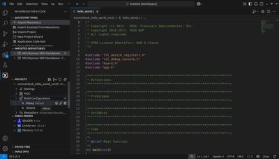

Ensure MCUXpresso for VS Code is properly installed.

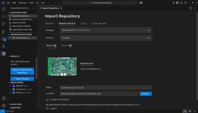

Import the iMX93-EVK SDK
Import "hello world" example

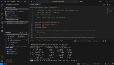

Ensure that we are compiling a debug binary
Build Project

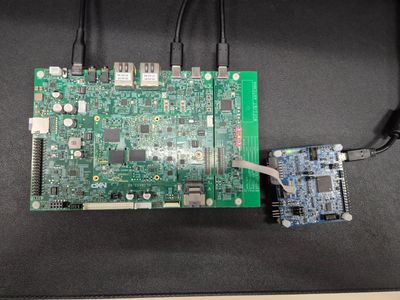

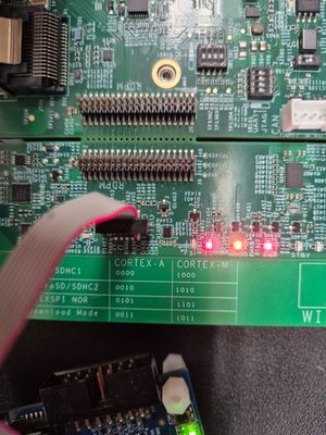

Connect MCU-LINK Pro to the Target
IMX93-EVK Debug connection:

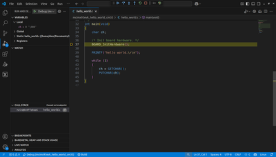

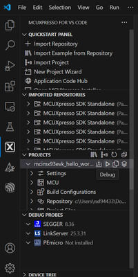

Start the Debug Session
Once the M core is launched, you can start your debug session in VS Code using MCUXpresso:
 With the MCU-LINK Pro configured, the IMX93-EVK, and the binary successfully flashed and executed, you are now ready to debug applications on the M core using MCUXpresso and VS Code. This setup enables a reliable development workflow for i.MX93-based projects.
