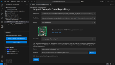

Compile the Binary for the M Core
Ensure MCUXpresso for VS Code is properly installed.
Import the iMX8MN-EVK SDK
Import "hello world" example

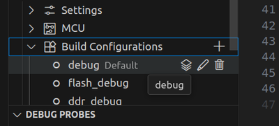

Ensure that we are compiling a debug binary

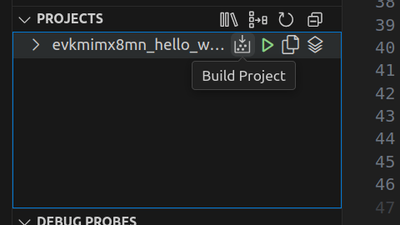

Build Project

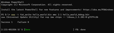

Flash the Binary using UUU Tool
Connect the IMX8MN-EVK Board to your Host PC via USB
Enter Fastboot Mode in U-Boot Terminal
=> fastboot 0
On your Host PC, navigate to the binary location and flash it using the next commands:
$ cd <project_location>/armgcc/debug/
$ uuu -b fat_write hello_world.bin mmc X:1 hello_world_debug.bin
Note: replace the X with 2 if you are booting from eMMC or 1 if you are booting from SD Card

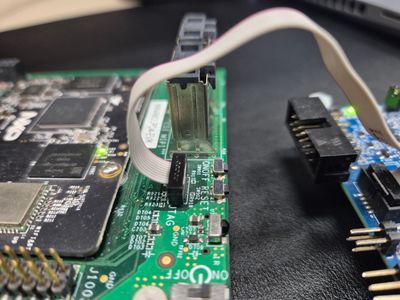

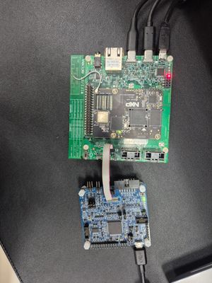

Connect MCU-LINK Pro to the Target
IMX8MN-EVK Debug connection:

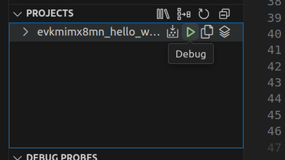

Start the Debug Session
Once the M core is launched, you can start your debug session in VS Code using MCUXpresso:
 With the MCU-LINK Pro configured, the IMX8MN-EVK, and the binary successfully flashed and executed, you are now ready to debug applications on the M core using MCUXpresso and VS Code. This setup enables a reliable development workflow for i.MX8MN based projects.
